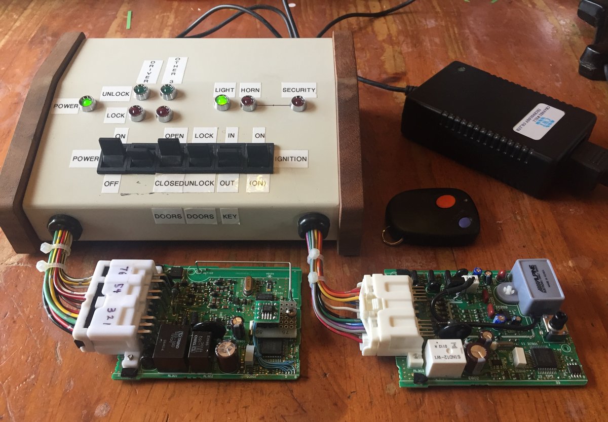

The good news is that my test jig is done and works perfectly.  I've tried a few of the keyless entry units and they function exactly according to the description.  So I can program one for the key fob(s) I want to use, then install it in the car and assess it for operation, both in "normal" use and in programming mode.  If it doesn't work for normal use, isolating the fault in the car wiring should be quick work.  If it does work, but won't enter programming mode, the keyswitch is still my first suspect.
[geek mode]
The one weird problem I'm having in the lab, though, is with the EEPROM that Alpine (presumably) stores the fob codes in.  It's a serial E^2 - 93C46, an old and very common part, and the Data I/O Unisite I'm trying to read it with is returning all zeros - nothing that looks like proper data.  Not sure what's going on there.

  1. Pulled the module from the car.
  2. Programmed it on the bench using this jig.
  3. Reinstalled it in the car.  Works perfectly.
I haven't tried programming it in the car, but I don't expect it to work.  When I get the time and inclination I'll probe the connector and see if I can see anything wrong, but I still strongly suspect a worn ignition switch.  This also doesn't solve the stuck-in-valet-mode problem that I had with my '02 Forester last year.  That's a function of the optional security module, which ties into the keyless entry module.  I don't want that part, so I don't care much, but sooner or later (probably sooner) curiosity is going to get the better of me and I'll add it to this jig.
p.s. Other than the chunk of harness taken from a car in the junkyard, built entirely of stuff I had lying around.

I've now hacked the security module onto my test jig and answered the question I started with last spring.
"Valet mode" does not inhibit the programming of new key fobs (transmitters).  I suspected that it does because my '02 Forester arrived in valet mode, without a working fob, I couldn't get it into programming mode to connect a new fob, and someone over on NASIOC claimed that a Subaru tech told them that it does.  I've now disproven that theory, and think that the same problem normally experienced preventing entry into programming mode was at work:  A badly worn keyswitch.  I continue to work toward (dis)proving this thesis.

And here it is with the security module added.  I really need to quit screwing with this stuff and go do something else...
Edited by jonathan909

Okayokayokay... if you're having fun watching me obsess over it (sicko), I've got one more bone I can toss you for now.
I threw the 'scope on the three wires that are used for communication between the two modules, and at first glance it doesn't appear they're running anything as complicated as the synchronous serial protocol I speculated about earlier.  I haven't done much with it yet - just watched the lines when I enabled and disabled the security system - and I think they just strobed one line to signal the change of mode.  I'll have to read a little more closely to see how many different states there might be and try to correlate that with how the state change signals might be encoded, and look at the microcontroller's data sheet to see what the pins (on each board) serving those three wires are capable of.
Other than getting in and out of valet mode I haven't been very interested in the security module, so I don't get yet what-all sets it off.  The easy thing to do on the bench is just give the shock sensor (that little grey box in the upper right) a little rap, but obviously there are a bunch of other conditions that can trigger it, so they'll represent different messages being passed.  We'll see about all that later.
