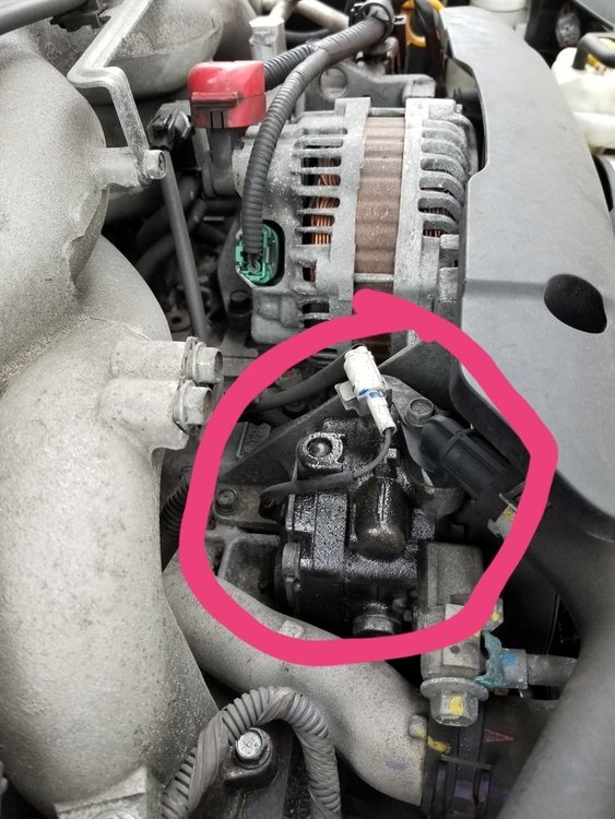

The Chad Posted May 4, 2019 Share Posted May 4, 2019 I've just noticed that this thing is covered with oil, what is it? I feel dumb, sorry to have to ask. Quote Link to comment Share on other sites More sharing options...
89Ru Posted May 4, 2019 Share Posted May 4, 2019 Power steering pump. There's an oring in the plastic fitting on top. Get from the dealer. Quote Link to comment Share on other sites More sharing options...
The Chad Posted May 4, 2019 Author Share Posted May 4, 2019 Very cool. Could I just order the O ring and fix it myself? Quote Link to comment Share on other sites More sharing options...
nvu Posted May 4, 2019 Share Posted May 4, 2019 assorted o-ring pack from autostore works fine Quote Link to comment Share on other sites More sharing options...
89Ru Posted May 4, 2019 Share Posted May 4, 2019 Heck yeah! It will leak a bit during the repair so have some rags handy. Just keep the fitting elevated some and it will drain into the reservoir. That plastic fitting can break so check for cracks. Get a old toothbrush and some mineral spirits before the repair to just brush off the top of the pump. Quote Link to comment Share on other sites More sharing options...
The Chad Posted May 4, 2019 Author Share Posted May 4, 2019 You guys rock, thanks. I haven't had to fix our Sooby in so long that I forgot what was what! Quote Link to comment Share on other sites More sharing options...
