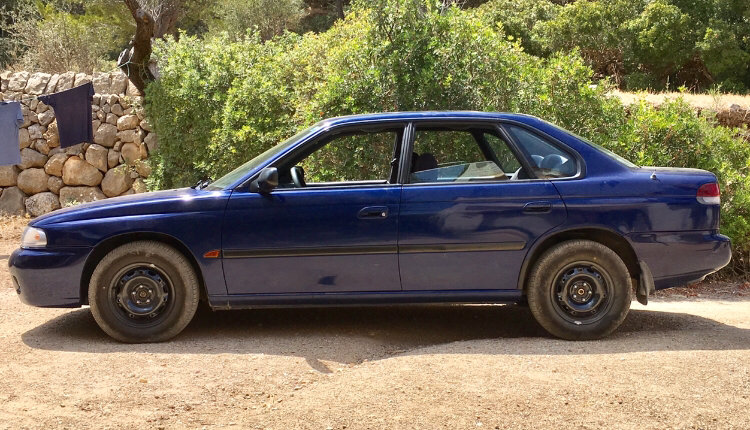

Introducing our newly acquired, 22 year old Legacy Sedan, to compliment our ‘99 Forester workhorse.
Super cheap (for here), super well maintained with only 90,000 miles. Original Dark blue Pearl paint, perfect upholstery, belts changed at 60k, regular services under its one owner, clean oils all around, and four tyres of the same model and Michelin brand, a comfort after my first Subaru purchase (Forester SF) required a new centre diff due to mis-matched tyres.
I picked it up cheap as the vendor did not even know it was AWD.
He wondered why I had asked for photos amongst others, of the underside of the rear end. When told him ‘differential’ he replied ‘its front wheel drive...’
when I answered ‘yes, as well ‘ his jaw dropped as he realised that he’d greatly underpriced this ageing, apparently unexciting generic Japanese sedan by quite a bit.
I did not haggle, to be fair to him....
Anyway, as in the vendor’s description, it runs like new, makes the right noises under all conditions, and is a pure joy to drive. I’m fresh in love with the EJ22.
To me its main fault is that it is a bit low to the ground, so a little 1” lift will be made soon.

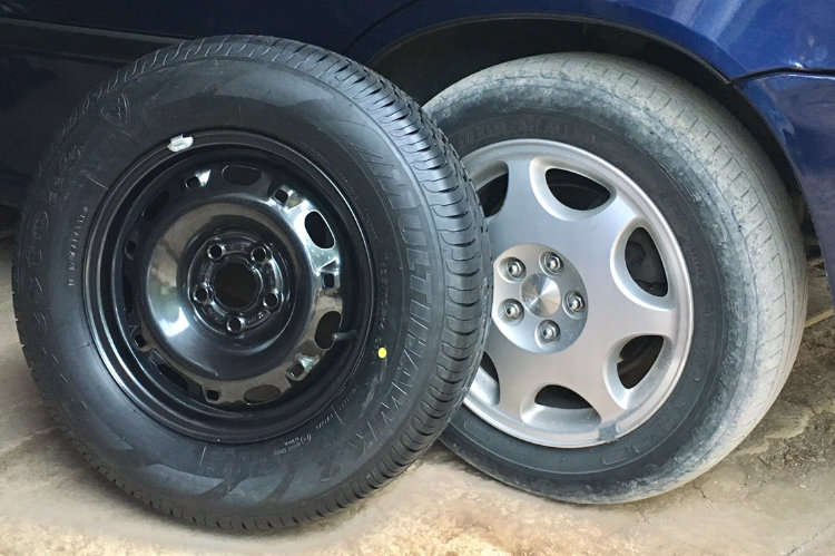

Oil and filters I changed yesterday, and earlier this week I replaced the 15” alloys with 14” steelies, (ugly)  VW type, and fitted using hub centric rings.
I’m now running on new 195/70 r14 Firestone Multihawk 2 tires, with much more sidewall than the worn Michelin 195/60 r15 they have replaced:
-much happier on our track now and no noticeable difference on the asphalt!

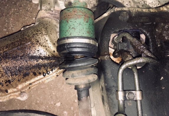

Aaargh!
cv boot split and spit- grease everywhere!
luckily I caught it early on. I then noticed that the cheapo outer boot on the same axle is severely deformed and leaking too.
I fished out one of the Forester’s original shafts which had the same inner boot split, and a good outer. Back in the day I just replaced it with a cheap aftermarket axle. A mistake, but that is another story....

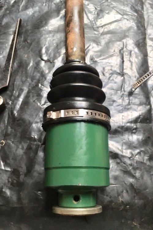

Forester axle rescued from the shelf:
I never restored a driveshaft before, so taking apart the tri-pot, cleaning and rebuilding without mixing up parts was fun... 3x 30 needle rollers:
but no big disasters, one minor stab wound and I have a shiny new cv joint to go back on:

Yep, same boot, almost the same issue as what you have there. A few more months (maybe) and it would’ve gone the same way as yours.
The other three boots up front are fine - because they’re not located near the exhaust! I’m lookig at making a heat shield for the boot to help increase its life expectancy.

@idosubaru
This now-repaired driveshaft was from our Forester, which I removed and foolishly replaced with aftermarket about four years ago, and I stored the original ‘as is’.
As I had not cleaned it it still had the same dirty brown grease in the tri-pot. This time I decided it should be properly cleaned and re-greased, therefore I took EVERYTHING apart. I think it is necessary if the grease is known to be contaminated, plus solvents used to clean the exterior will undoubtedly get in between the needles and dilute the old grease.
Looks good, but the old contaminated grease inside is not reliable:
Each of the three bearing assemblies on the tri-pot has a snap ring holding it in place. When this is removed, the bearing components just slide/fall out, depending on whether you expect it.
I blindly followed the Haynes advice (no snap rings holding the bearings on their model Outback), it was no big deal to remove and reinstall the needles. One bearing at a time, check positions of races first, etc. Just slide them in, one by one. At least I know they are freshly greased inside there! They roll much, much firmer than before, a good thing.
This repaired Forester one is going on the Legacy and then I can repair the newly-split Legacy one and put that on the Forester, as the 90$ aftermarket replacement  is now split, clicking and creaking after just four years.

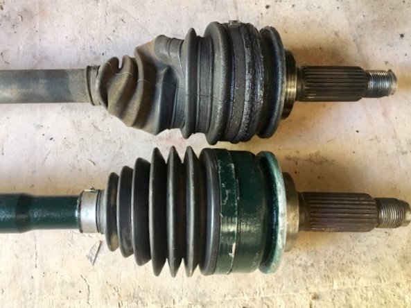

Quick comparison between the old ‘97 Legacy axleshaft and the ‘99 Forester’s donated and renovated shaft. The shafts are different, the Forester’s has a thicker shank, chamfered-out from the inner boot. All else appears to be the same, phew!.....
-There is a good reason not to use ‘universal fit’ aftermarket boots and plastic cable ties.... the top joint had lost most of its grease at the wide end of the boot, coating the knuckle, control arm and brake cylinder housing. Well done you......
That’s also a reason that I don’t pay local “mechanics” do do my dirty work. I have seen enough botch jobs due to lack of knowledge or laziness, I don’t trust them further than I can throw them.
So it is now installed and rolling nicely, 2 hours of taking it easy, cleaning up the grease spurts, and having a good look around.
How much does this job cost?
25€ for the boot kit. And I did it before breakfast! I reckon the previous poor repair cost 10 times as much.
——The worst part was manoeuvring the control arm to reinsert the ball joint, until I remembered to loosen the ARB slightly on the chassis and pop out the drop link from the control arm. Duh, Then it just found the hole.- Just remember to let the car down again on its wheels to re-tighten the ARB bolts!——
To disassemble the control arm from the balljoint I used the old trick of first loosening the castle nut a few turns, jacking up the knuckle (on the bottom outside edge of the brake disc with a wooden pad and the brakes engaged), placing packing (a non-valuable steel thingy) snugly between the knuckle and control arm, without squishing the balljoint rubber, and releasing the jack. If the metal packing thingy is the right size, it always pops out for me. So satisfying!
No penetrating oil, nothing. Rusty cars may be different!
No smashing or mashing with pickleforks either, I hate whacking my parts with hammers.

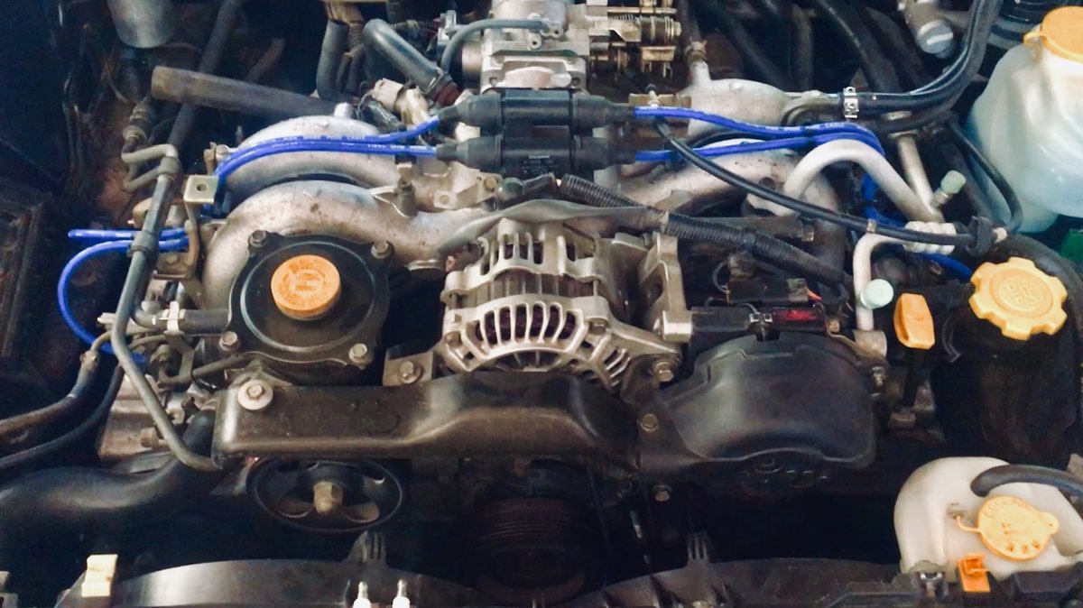

Now that the repairs are done, I made the time to put the new plugs in too.
NGK plugs and cables.
Old plugs look great, but I don’t know how old they are. The old cables were the original Packards.
Small investment.

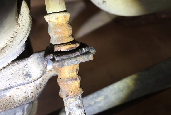

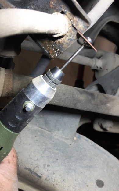

I have been making the most of time off between jobs, and today I finally got the rear struts out and lengthened, and mounted again!
Tomorrow I hope to repeat with the fronts.
Rear seats out, to gain some access to the top nuts, still tricky to access!
Then cut the brake hose brackets, as I have no need to bleed the brakes yet.
Those ‘helpers’ don’t look to good- the texture of moist digestive biscuits!
No big problems, the hdpe spacers went on with no trouble, and it went back together quite quickly and smoothly. The second strut definitely took half as long as the first, of course!

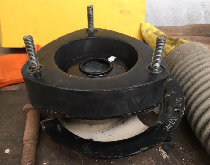

Paint marks on the strut bottom, rubber seat, spring, top seat and strut top really helps with reassembly.
Here is the 30mm spacer going on:
Don’t forget to flip that cut tab back up and grease the clip:
Not a huge difference at the rear, but it will help clear those rocks on our ‘camino’.

I cut the brake hose brackets with this little thing. 7DB45415-A385-4C64-A47C-FA9F5197BA5C.jpeg.b8c72b2272f9964c8bfa57b826bb1865.jpeg
I use the wheel nut wrench from the tool kit to loosen and tighten the lower strut bolts. I also use a long cheater bar.8DEF0948-3F53-4DFD-99C9-D05B0E44D2BE.jpeg.3352dabcd94fd741bdac053452e5998c.jpeg
