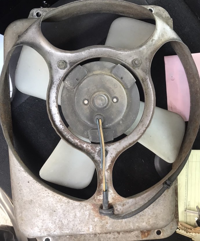

The plug is cut off. I thought this fan was off my Brat. Might not have been. I salvaged some parts off an EA81 station wagon many years ago. If you don't mind splicing your plug on I do have the fan. I will check it with my 12v jump pack to make sure it runs and has no issues.
Yes, fan works!
Yes, fan works!
Looks like it’s the same.
