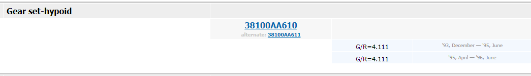

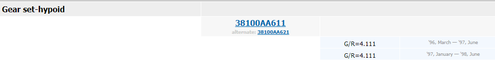

wtdash Posted June 10, 2019 Share Posted June 10, 2019 (edited) Per the attached from opposedforces.com they should both be (G/R) 4.111. They're both running the EJ22 / 2.2. One thing is Subaru changed the rear diff's flange bolt spacing around '95, so that 'could' be a gotcha, too. Edited June 10, 2019 by wtdash Quote Link to comment Share on other sites More sharing options...
