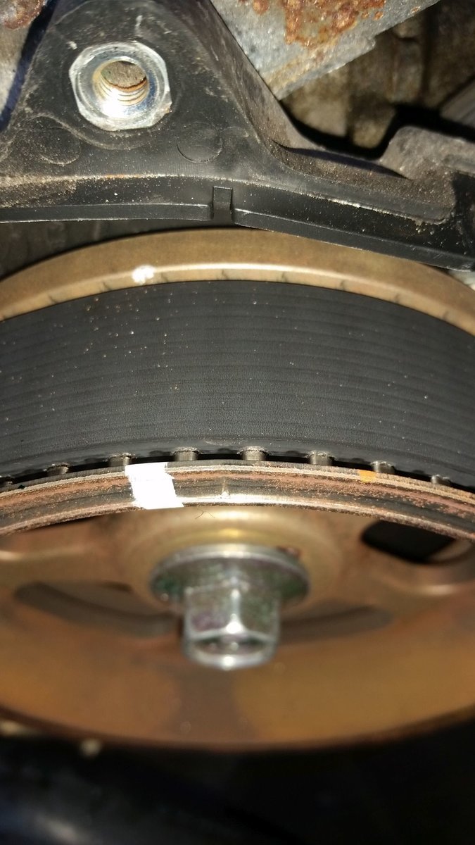

TimeBandit Posted June 29, 2019 Share Posted June 29, 2019 Posted this over on subaruoutback.org, but hoping for some help here. I did the timing belt on my 2011 Outback about a month ago. Since then the car has been a bit low on power with subpar throttle response. I just pulled the timing covers to check whether I may be off a tooth. Going by the service manual, I get 47 teeth between the right cam sprocket and crank (Z1). But I'm unclear where to start counting from for the number between the left cam sprocket and the crank. Right now, the belt has a tooth directly in line with the timing marks, but according to the service manual, I should be counting starting with the first tooth to the left of the marks (facing the front of the engine). Depending on whether or not I include that tooth that's in line with the marks, I'm either at 43 or 44, with the former number being a tooth off. Any input would be appreciated. Quote Link to comment Share on other sites More sharing options...
FerGloyale Posted June 29, 2019 Share Posted June 29, 2019 Ignore the mark on the plastic cover to some extent. Instead, line the mark up with the Cam Case to Head seam. This will also be exactly 12 0'clock. It's common for the plastic covers to be off a bit, resulting lining up at about 11:58, to continue the o'clock analogy. Can you take a picture standing back a bit? So we can see a reference to the whole engine a bit? My guess is you are off one tooth. Did the belt you used have marks alignment marks on it? If so how did those line up when you installed? Quote Link to comment Share on other sites More sharing options...

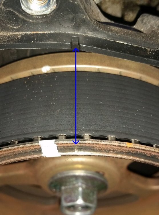

TimeBandit Posted June 29, 2019 Author Share Posted June 29, 2019 I had to button things back up again for now, so I can't take any more pics until I go in there again. I've attached the original un-cropped version of the first photo, since that gives a little more context. I had lined up the two cam sprockets and crank sprocket with the original factory belt before removing it. Then I positioned a new Mitsuboshi belt so that the three alignment marks painted on it were as close to directly in line as possible with the sprocket marks and the reference marks above them (which was probably more than 95 percent in line). Cranked the engine over by hand twice to check that all three sets of marks were still in line, and they were. I did recount the teeth between the left cam sprocket mark (not the mark on the cover above) and the crank sprocket mark. I actually get 43.6 - 43.7, which is what the service manual specs. Quote Link to comment Share on other sites More sharing options...
