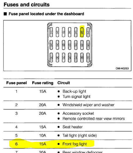

Hi  all:
  My fog light on my 1996 Outback  are not functioning but the switch in the dash board turns on. I cant find a location of a fuse i look both fuse boxes inside and outside.
any ideas, Thanks...
