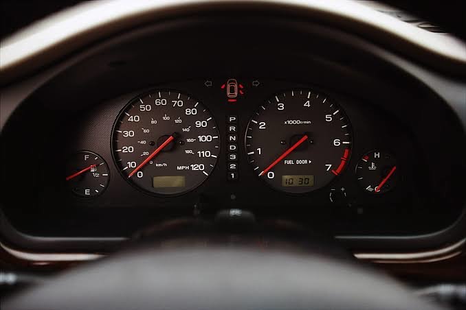

subieroo Posted August 19, 2019 Share Posted August 19, 2019 Just a quick question, I know OEM gauges aren't that accurate, but where does the needle normally sit on these things? Is it supposed to be down near the bottom in the small, notched section or in the middle? My mother's H6 runs in the middle and I suspect it has a pinhole leak in a head gasket, the coolant overflow always bubbles away, radiator fans always running, rare but frightening temperature spikes, just need something "visual" I can show her to at least pursue fixing it... Picture is of a cluster with the same gauge Quote Link to comment Share on other sites More sharing options...
FerGloyale Posted August 19, 2019 Share Posted August 19, 2019 Middle. Quote Link to comment Share on other sites More sharing options...
subieroo Posted August 19, 2019 Author Share Posted August 19, 2019 1 minute ago, FerGloyale said: Middle. Sweet, but I still suspect blown HG. She missed 8 oil changes, changed oil air and fuel filters once in 3 years. Has blown a radiator before. The overflow needs topping up frequently because it boils out. No signs of external coolant leaks and I have burped it thoroughly once for her, still slowly boiling. As I understand it HG failure on a EZ30 is rare but I'm sure that level of neglect could do it... Quote Link to comment Share on other sites More sharing options...
