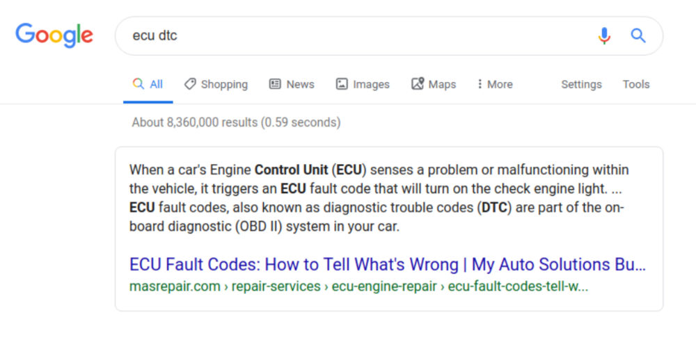

Tims Toy 500 Posted August 23, 2019 Author Share Posted August 23, 2019 (edited) 11 hours ago, 1 Lucky Texan said: sometimes there are pending codes stored - you might scan the ECU for DTCs. A parts store can do that for you. I'll admit, I'm old school. Gimme a Carburetor any day. But I need to keep up. I bought a scantool and as mentioned, it came up with nothing... Google says: "When a car's Engine Control Unit (ECU) senses a problem or malfunctioning within the vehicle, it triggers an ECU fault code that will turn on the check engine light. ...ECU fault codes, also known as diagnostic trouble codes (DTC) are part of the on-board diagnostic (OBD II) system in your car." So - wouldn't it "turn on the check engine light" - even if the're "pending codes stored"?? Do scan tool's not normaly "scan the ECU for DTCs"? What am I missing? (Don't get me wrong. I know Google is not the expert. I had to look up "DTC".) Thanks for your help. Edited August 23, 2019 by Tims Toy 500 Quote Link to comment Share on other sites More sharing options...
