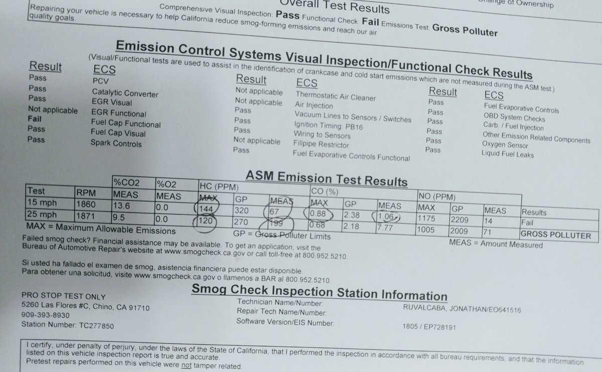

oczuk32 Posted September 19, 2019 Share Posted September 19, 2019 So my wagon has fail smog twice so far. I have replace plugs, fuel filter, air filter, cap & rotor, pcv, checked fuel pressure regulator. Except O2 sensor. O2 sensor looks like it had been replace before. I notice that when O2 sensor is unplug it runs a little leaner and when i plug it in it starts to get in the rich side. I having a problem trying to reach the O2 sensor with the standard O2 socket. The heat shields on the turbo and cat make it difficult. The service manual calls out for a special socket for the sensor which i assume it doesnt exist anymore. Any suggestions... Quote Link to comment Share on other sites More sharing options...

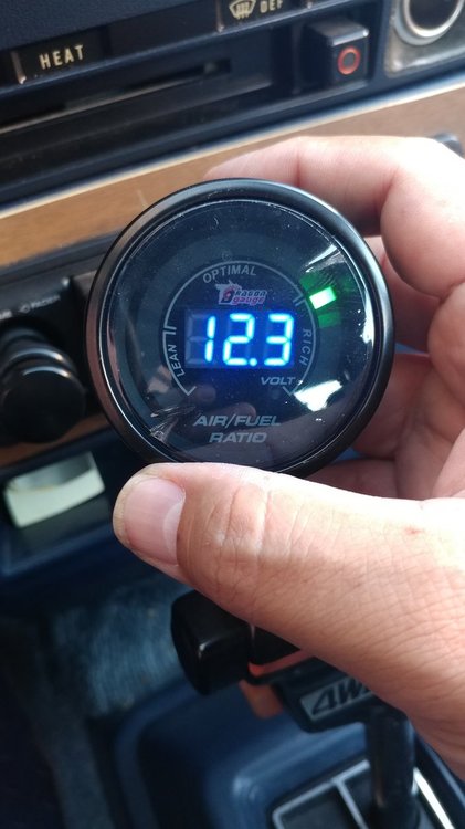

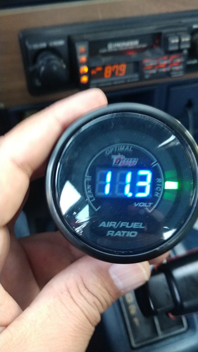

oczuk32 Posted September 28, 2019 Author Share Posted September 28, 2019 Update. So I drove it the car for a bit and it seems that the rich smell has gone away and AFR monitor is taking the readings from the ecu adjustments. So far its stable at 12.1 on AFR. 1 Quote Link to comment Share on other sites More sharing options...
Steptoe Posted September 28, 2019 Share Posted September 28, 2019 You want 14.7 cruising, backing off acc pedal totally should cut injectors totally and give you lean as like 29.9 if your gauge goes that far and some ecu will trigger CEL only while in this super lean condition. You could work out if it is 0.1 V to 0.5V that is the lean half and 05 - 0.9v the rich range and just bypass O2 sensor and feed ecu that tiny voltage to keep ecu lean for next inspection Quote Link to comment Share on other sites More sharing options...
oczuk32 Posted September 29, 2019 Author Share Posted September 29, 2019 (edited) 2 hours ago, Steptoe said: You want 14.7 cruising, backing off acc pedal totally should cut injectors totally and give you lean as like 29.9 if your gauge goes that far and some ecu will trigger CEL only while in this super lean condition. You could work out if it is 0.1 V to 0.5V that is the lean half and 05 - 0.9v the rich range and just bypass O2 sensor and feed ecu that tiny voltage to keep ecu lean for next inspection Yes 14.7 is the ideal mixture. But going thru some turbo forums they mention that engines with turbos should run a little richer than naturally aspirated engines. 12.8 to 13.7. Correct me if i wrong. My experience with turbos is very limited. Yes when i back off the accelerator it does go to 27.0 + on AFR Oh FYI, I have the AFR plug in into a whole different oxygen sensor after the cat on the exhaust. Edited September 29, 2019 by oczuk32 Add more info. Quote Link to comment Share on other sites More sharing options...
