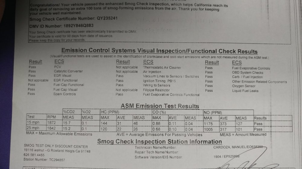

oczuk32 Posted October 4, 2019 Author Share Posted October 4, 2019 So heres the final readings Im getting after adjusting the air fuel mixture. Thats the best i could get at 800 rpm idle. Taking it in Saturday for another and hopefully final smog test. Quote Link to comment Share on other sites More sharing options...

oczuk32 Posted October 18, 2019 Author Share Posted October 18, 2019 Finally Passed Smog.... Smog technician was surprise on how clean the wagon is running. Now I could move one to other simpler things the wagon needs. Thanks for the help and knowledge on this post. 2 Quote Link to comment Share on other sites More sharing options...
