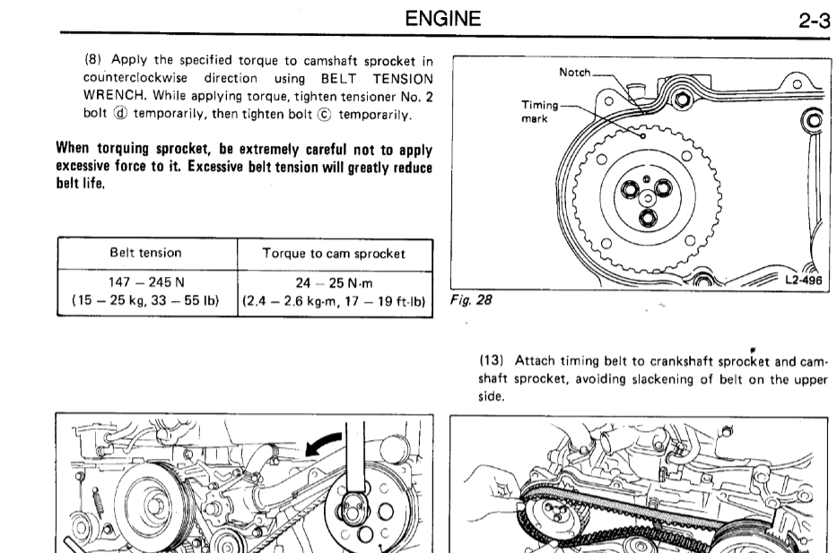

Get the FSM and follow the tensioner procedures.  I attached one side shown here.  Put tension on the cam sprocket as you tighten the tensioner pulley bolts.  Do both sides.
I don't think this should be causing low power and/or idling issues though.  I've installed them without tensioning the cam's and they run just fine...but there's more things at play here so who knows.
Your belts are too loose, but that won't cause the running problems.  Loose belts are at more risk to skip timing.  I do is correct, read and follow the FSM procedure for setting the tension.   I add the step of a 5 second run and then reset tension.  The belts inevitably move to the location they want to run, and end up loose.
