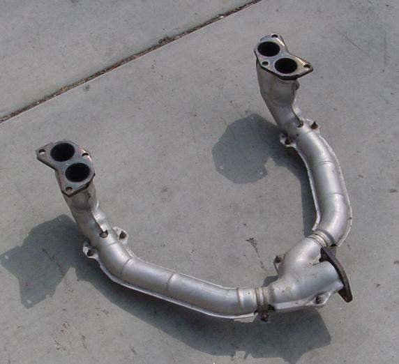

Cfoust Posted January 12, 2020 Author Share Posted January 12, 2020 23 minutes ago, Rampage said: Look at the bottom of the head where the exhaust Y-pipe connects. It will have 1 or 2 pipes going to the head. So would this be a dual port style? If i recall from when i did my oil change this was what the manifold looked like Quote Link to comment Share on other sites More sharing options...
Rampage Posted January 12, 2020 Share Posted January 12, 2020 Yes, that is duel port. I am surprised because partsgeek lists the 96 2.2 as a single port. It lists the 2.5 as a dual port. Our 97 had the single port, but I changed the heads to 95 heads because they have hydraulic lifters and they have dual port like in your picture, so I had to use the 95 Y-Pipe. Quote Link to comment Share on other sites More sharing options...
Cfoust Posted January 12, 2020 Author Share Posted January 12, 2020 2 hours ago, Rampage said: Yes, that is duel port. I am surprised because partsgeek lists the 96 2.2 as a single port. It lists the 2.5 as a dual port. Our 97 had the single port, but I changed the heads to 95 heads because they have hydraulic lifters and they have dual port like in your picture, so I had to use the 95 Y-Pipe. Oh ok, i will definitely take a closer look Quote Link to comment Share on other sites More sharing options...

idosubaru Posted January 13, 2020 Share Posted January 13, 2020 On 1/11/2020 at 7:47 PM, Cfoust said: Hey guys im trying to do a full exhaust system on my 96 obw, its a 2.2 5spd. Verify. Originally that had a single port exhaust, but you're thinking dual. First task is to look and take a photo or verify this. Could have easily had an engine swap....or three. Quote Link to comment Share on other sites More sharing options...
Cfoust Posted January 13, 2020 Author Share Posted January 13, 2020 So i just look and saw its a single port setup. Will a impreza manifold fit? Quote Link to comment Share on other sites More sharing options...
wtdash Posted January 14, 2020 Share Posted January 14, 2020 Yes....as long as it's single. Quote Link to comment Share on other sites More sharing options...
