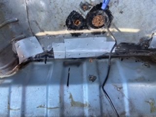

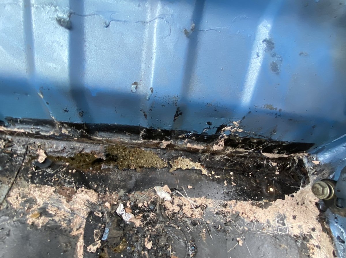

TXJayhawk Posted March 23, 2020 Share Posted March 23, 2020 (edited) Big hole behind drivers seat passenger seat small areas rear cab to bed panel Edited September 18, 2020 by TXJayhawk Quote Link to comment Share on other sites More sharing options...

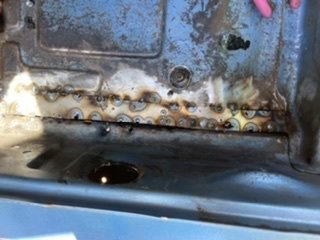

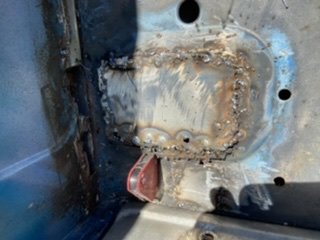

TXJayhawk Posted March 23, 2020 Author Share Posted March 23, 2020 Only one that really is concerning is the drivers side but clean metal is available for welding -not cleaned yet in this photo Quote Link to comment Share on other sites More sharing options...

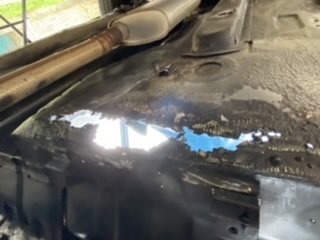

andrsn Posted May 26, 2020 Share Posted May 26, 2020 I got some in the same spots between cab and bed... what a pain Quote Link to comment Share on other sites More sharing options...

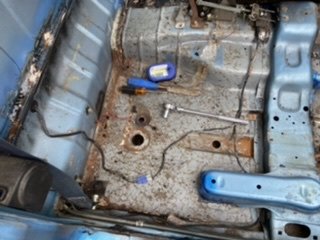

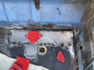

TXJayhawk Posted May 26, 2020 Author Share Posted May 26, 2020 (edited) my first crappy welds but will get better with practice (got a little better but not much) Edited September 18, 2020 by TXJayhawk Quote Link to comment Share on other sites More sharing options...

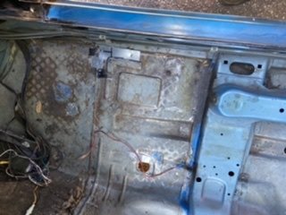

TXJayhawk Posted June 15, 2020 Author Share Posted June 15, 2020 (edited) Passenger side due to brake and fuel lines riveted/glued in patches Edited September 18, 2020 by TXJayhawk Quote Link to comment Share on other sites More sharing options...

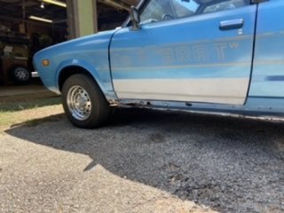

TXJayhawk Posted June 15, 2020 Author Share Posted June 15, 2020 (edited) Door panels and tailgate done using brazing technique Edited September 18, 2020 by TXJayhawk Quote Link to comment Share on other sites More sharing options...

ironworkerboomer Posted July 16, 2020 Share Posted July 16, 2020 Here is a nickels worth of advice. When welding sheet metal use a spot weld and random places to keep the heat from warping the patch. It will be a stronger weld in the end. Great project cheers, Shane Quote Link to comment Share on other sites More sharing options...

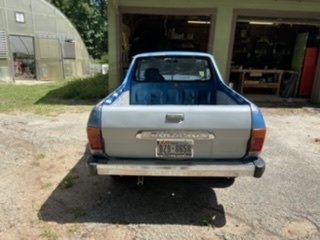

TXJayhawk Posted July 23, 2020 Author Share Posted July 23, 2020 (edited) Lots done cab and bed welded/riveted with POR 15 on cab side and seam sealer outside over self etching and regular primer bed will get a truck bed liner eventually quarter panels and rear cross welded and finished with fiberglass-putty to cover floorpans welded/riveted with POR 15 Edited September 16, 2020 by TXJayhawk Update Quote Link to comment Share on other sites More sharing options...
TXJayhawk Posted September 16, 2020 Author Share Posted September 16, 2020 (edited) Bed is done Brushguard repainted wheel well hole filled and sealed rocker panels sprayed Edited November 1, 2020 by TXJayhawk Reassembling Quote Link to comment Share on other sites More sharing options...
TXJayhawk Posted March 12, 2021 Author Share Posted March 12, 2021 Currently at the mechanic (just waiting on a new fuse box), all new brakes front and rear, including calipers, brake hoses, brake pads, hardware, rear wheel cylinders, drum linings, master cylinder), new suspension bushings (sway bar, lower control arm to rear cross member), new rubber coupler, new steering rack, alignment; rewire the fuel pump properly, bypass the broken hazard switch with a rocker switch, and new modern style fuse box in place of the old glass style. Was it expensive? Yes, but having owned it for 22 years, hopefully another 22 will make it all worth it! Next up, filling in all the little scratches and a home done paint job (Eastwood Mulsanne Blue flake), original Brat decals, and original aftermarket chrome side rails to be installed. Todd in Dallas has wheels, stripe kit, and seats that I need to pick up soon and then it will be done for now. Quote Link to comment Share on other sites More sharing options...
