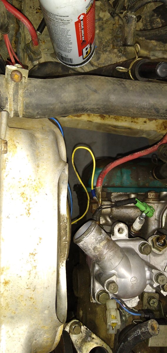

Skubaskott Posted March 30, 2020 Share Posted March 30, 2020 I am almost done with the swap but I'm at a bit of a loss as to what to do with the coolant hose. Quote Link to comment Share on other sites More sharing options...
el_freddo Posted March 30, 2020 Share Posted March 30, 2020 Try the factory L series unit or rotate the thermostat housing 180*, make an elbow piece to marry to the factory hose and use a small piece of hose for the gap between the adaptor piece and the thermostat housing. The factory L series upper hose would be way easier though! Cheers Bennie Quote Link to comment Share on other sites More sharing options...

Steptoe Posted April 2, 2020 Share Posted April 2, 2020 I found that EA82 non XT run very similar top and bottom hoses In order to keep reduced inventory suppliers often list same part number for top and bottom And I think the number belongs to the bottom hose I ran this EA82 spfi manifold in myEA81 Brumby and used bottom EA82 hose, possibly cut 10 mm off engine side Quote Link to comment Share on other sites More sharing options...
carfreak85 Posted April 2, 2020 Share Posted April 2, 2020 Those uninsulated wire connections give me heartburn... 1 Quote Link to comment Share on other sites More sharing options...
Skubaskott Posted April 3, 2020 Author Share Posted April 3, 2020 I got it figured out guys! Thanks.i used the original hose of the eA82. Actually worked perfect. I found behind my workbench. 1 Quote Link to comment Share on other sites More sharing options...
Skubaskott Posted April 3, 2020 Author Share Posted April 3, 2020 23 hours ago, carfreak85 said: Those uninsulated wire connections give me heartburn... Thier ground from whoever had it before me Quote Link to comment Share on other sites More sharing options...
Skubaskott Posted April 3, 2020 Author Share Posted April 3, 2020 On 3/31/2020 at 9:46 AM, Rafavidmess said: Hi, Are you adapting a SPFI system to an EA 81 Engine? That´s a change I would really like to do on mine. ¿Can you give me more information? Parte needed, major issues, etc Thanks in advance! Maijor issues are wireing. I'm having trouble with the coil not getting power which in turn causes the fuel pump to not get power Quote Link to comment Share on other sites More sharing options...
