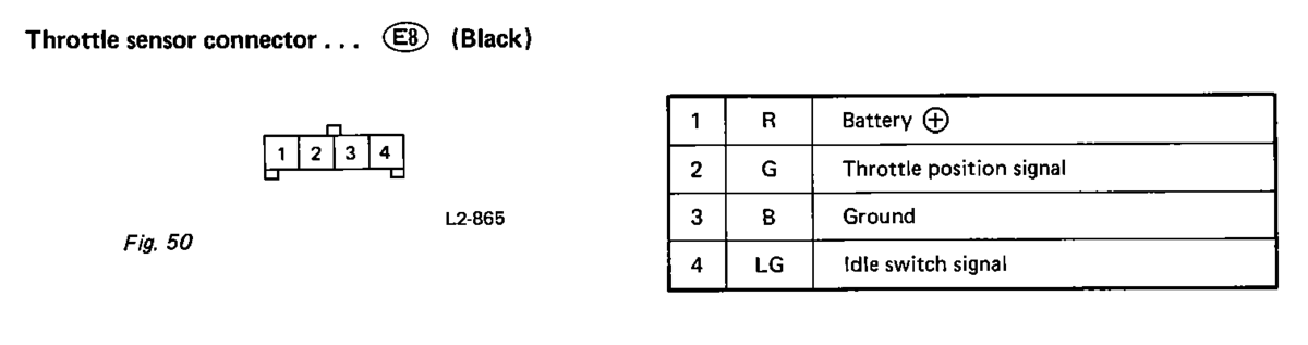

Would anyone be able to get a picture of the orientation of those wires into the tps? I have been able to find 3 pin versions all over but not the 4 pin which I believe is a later model part.

I can see the remaining wires coming from the firewall but everything on the tps is gone except the metal connectors.
It is a SPFI. Even when I go to the parts store they can only find the 3 pin sensor. But from what I can see this one was factory wired for the 4 pin it's got.
My Chilton shows the tps as being for a 2.2ltr. Mpfi.

I got it wired up. It runs a bit better but still boggs down when the throttle is applied. I'm sure I've got other issues to work out tho. Thanks for the help.
