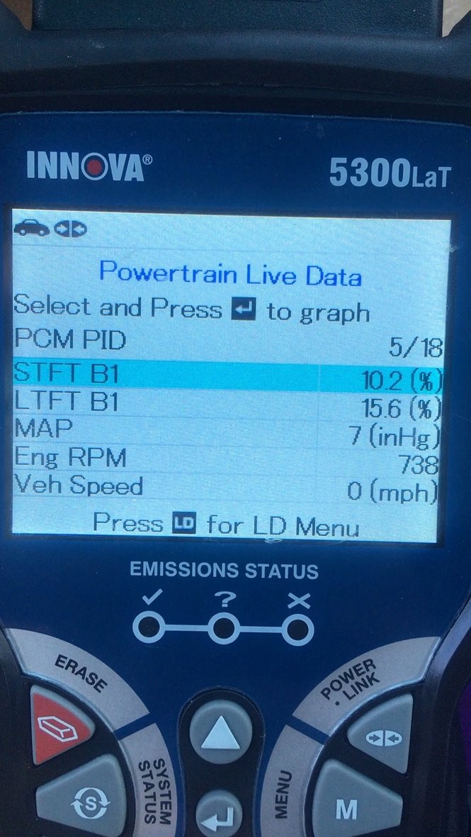

GeneralDisorder Posted July 5, 2020 Share Posted July 5, 2020 (edited) You have a serious lean condition. The two trims added together should be no more than plus or minus 5%. Here's the possibilities: 1. MAF is under-reporting airflow. Seems unlikely considering the reading from it. 2. O2 sensor is skewed and reporting a lean condition. Or you have a constant misfire - which is interpreted as a lean. 3. Fuel pressure is low or injectors are partially plugged. Resulting in unpredictable injector flow and the ECU is compensating by raising the fuel trims. Post a video of the engine idling. And do a kill test of every cylinder by unplugging the injectors one at a time. GD Edited July 5, 2020 by GeneralDisorder Quote Link to comment Share on other sites More sharing options...

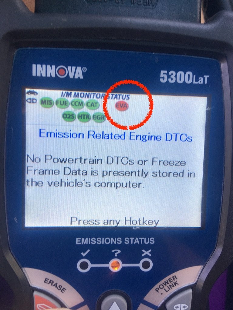

suprunner Posted July 6, 2020 Author Share Posted July 6, 2020 6 hours ago, GeneralDisorder said: You have a serious lean condition. The two trims added together should be no more than plus or minus 5%. Here's the possibilities: 1. MAF is under-reporting airflow. Seems unlikely considering the reading from it. 2. O2 sensor is skewed and reporting a lean condition. Or you have a constant misfire - which is interpreted as a lean. 3. Fuel pressure is low or injectors are partially plugged. Resulting in unpredictable injector flow and the ECU is compensating by raising the fuel trims. Post a video of the engine idling. And do a kill test of every cylinder by unplugging the injectors one at a time. GD Hi Rick, I'll get a video of it idling tomorrow. I'll try to get it during the hottest part of the day to see if it shows everything I'm trying to describe. I've had this motor build for about 4 years now, with the same symptoms, it's just that I'm now living in the desert heat so the symptoms are always present. The symptoms followed the motor when it was transplanted into the OBW that I'm now driving. The only electronic components that are still on it from the beginning are the injectors, cam sensor and crank sensor. The MAF has been swapped out between two used OEM units, and an AC delco reman. Ignitor and coil are not original either, but there was no change in symptoms. About 4 months ago I had the injectors out, and I cleaned out all the filters, and soaked the tips in some isopropyl alcohol. There was no change after installation. Thanks for your time, Greg Quote Link to comment Share on other sites More sharing options...
suprunner Posted July 6, 2020 Author Share Posted July 6, 2020 On 7/5/2020 at 12:51 PM, GeneralDisorder said: You have a serious lean condition. The two trims added together should be no more than plus or minus 5%. Here's the possibilities: 1. MAF is under-reporting airflow. Seems unlikely considering the reading from it. 2. O2 sensor is skewed and reporting a lean condition. Or you have a constant misfire - which is interpreted as a lean. 3. Fuel pressure is low or injectors are partially plugged. Resulting in unpredictable injector flow and the ECU is compensating by raising the fuel trims. Post a video of the engine idling. And do a kill test of every cylinder by unplugging the injectors one at a time. GD Sorry for the length, it was hot outside and the engine bay was quite warm, I was fumbling on touching things. There are a couple instances where the motor does stumble on its own without me doing anything. I tried increasing RPMs to show the odd range of motor unbalance, but I'm not sure it shows well in the video. Unplugging injectors 1, 2, and 4, caused the motor to really bog and shake... Unplugging injector #3 had minimal change to the idle. Change it out? Quote Link to comment Share on other sites More sharing options...

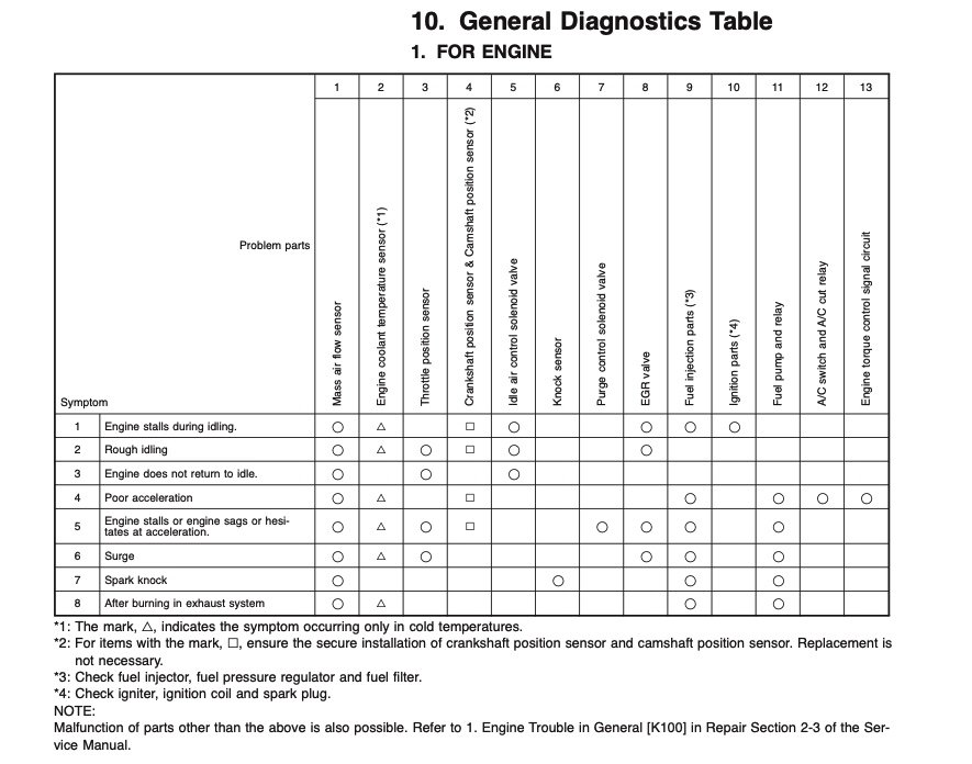

suprunner Posted July 18, 2020 Author Share Posted July 18, 2020 I've found this. I'm assuming that I should start here. The MAF has been cleaned, but it is old, and all my symptoms are under the MAF column.. Is there a diagnostic section on each of the components here? Same for TPS... Quote Link to comment Share on other sites More sharing options...
