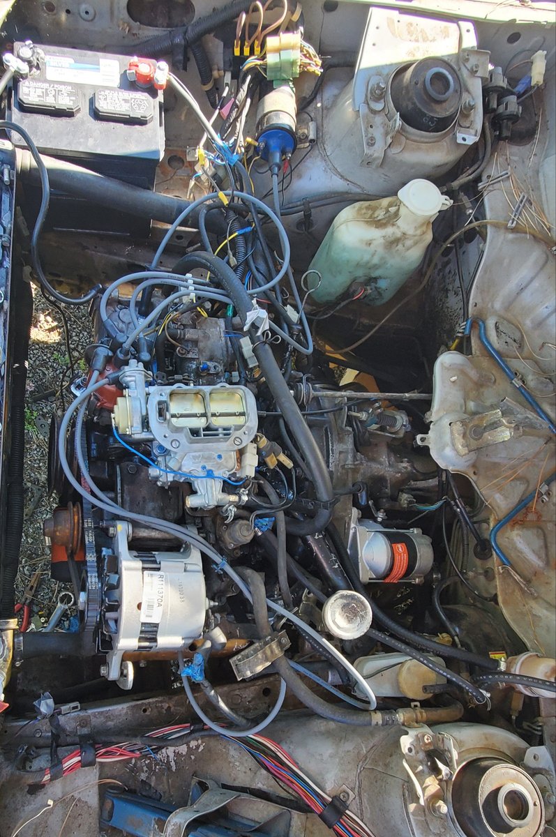

I have an 84 GL Wagon 4WD here that has been giving me one hell of a run for my money. I pulled the motor last summer and everything went fine. I only replaced intake manifold gaskets, exhaust header gaskets, head gaskets, and oil pan gaskets, no internals. Got it back in and everything went fine and it sat all winter in my driveway. This summer, I got in it, it fired up, idling kind of rough and drove it about 300 yards down the road and back up. Everything was fine. Upon trying to start it days later I was getting spitting out of the carb. I went full bore and replaced the ignition switch, distributor cap, fuel pump, entire carbeurator to the weber dgv 32/36, tuned the carbeurator to the specifications, replaced the alternator and starter. I am getting power to the starter relays, the starter, the battery has 12v, and the ignition coil. I was getting power to the dash when I turned the switch to the ACC position and the fuel pump would prime. But I turned it off and back once more and all the dash lights shorted out. Now I only hear a click from the starter relay when I turn to the ACC position. The car still cranks over but I have no power to the fuel pump as the under hood fuel filter emptied.

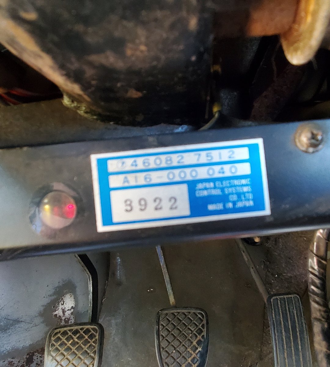

I noticed that in the ACC key position the ECU has a red light that flashed every couple seconds.
