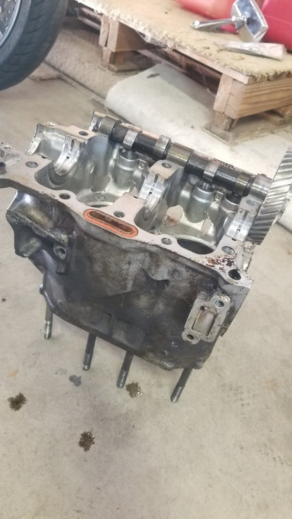

UnorganizedMechanic Posted August 27, 2020 Share Posted August 27, 2020 (edited) After splitting the block and freeing everything from the cylinders on my 1984 Brat's EA81, I was left with rusty and questionable walls. All the rust is gone and I put a deglazer and ball hone to smooth it as much as I could but I'm still left with almost imperceptible pitting and stains. Anybody just say fuggedaboutit, put it back together with new rings looking like that and have little to no problems? I'm trying to save money but fully ready to bite the bullet in the future if a cleaner block if one comes up. Long story short, in your collective experiences do you think these walls are acceptable? I'm willing to take a chance. I'm also ready to get a few harder stones for my cylinder hone and just go to town until it's smooth enough. Not sure how these engines take to it though. Any, and all advice is greatly appreciated. Edited May 5 by UnorganizedMechanic Quote Link to comment Share on other sites More sharing options...
DaveT Posted August 27, 2020 Share Posted August 27, 2020 (edited) Hard to tell how deep the damage is. ... my guess is it will burn more oil than normal. So use cheap oil. I ran an EA82 for years, that had been overheated, and I did a reseal, but didn't think about the possibility that the oil rings could be shot. It burned a quart with every tank of fuel. I used the waste oil from other cars, mixed with new what ever I found on sale 10w 40. For years. Edited August 27, 2020 by DaveT Quote Link to comment Share on other sites More sharing options...
GeneralDisorder Posted August 27, 2020 Share Posted August 27, 2020 Whole lotta nope. That's garbage unless you bore it oversized. Not likely worth the effort and custom pistons. Just huck that out behind the dumpster. GD Quote Link to comment Share on other sites More sharing options...
Step-a-toe Posted August 27, 2020 Share Posted August 27, 2020 (edited) Only one way to find out -try it. There are cars getting around that have been bodged up and put back together and likely give some reliability until it poos itself. A mate used to say " back home in (select your Baltic country) we wouldn't have had a choice but to stick it back together" Depends what and how you use it too Edited August 27, 2020 by Step-a-toe Quote Link to comment Share on other sites More sharing options...
ferp420 Posted August 31, 2020 Share Posted August 31, 2020 I would run it what's the worst that could happen you loose some compression burn some oil Don't expect it to be a daily driver but it should run OK till it dosent Quote Link to comment Share on other sites More sharing options...

UnorganizedMechanic Posted September 2, 2020 Author Share Posted September 2, 2020 On 8/26/2020 at 9:29 PM, GeneralDisorder said: Whole lotta nope. GD Hehe, I like it. On 8/26/2020 at 10:33 PM, Step-a-toe said: Only one way to find out -try it. There are cars getting around that have been bodged up and put back together and likely give some reliability until it poos itself. A mate used to say " back home in (select your Baltic country) we wouldn't have had a choice but to stick it back together" Depends what and how you use it too In Soviet Russia, car smoke you! I think I've decided to go for it. I'm putting some new rings and bearings in it, honing the walls until I feel OK, then praying as I start it up. Most likely running a thicker oil and we'll see what the speed gods have in store for me. 1 hour ago, DLGL8388 said: I've got 2 old e 81 motors that you could have. Dang, that's awesome. But I'm in California and who knows what shipping would be like. If the poopoo hits the wall, for sure I'd appreciate having the option. Thanks DLGL8388. The price of boring it out, putting new pistons and rings would be probably the same, or more, as getting a used motor. Quote Link to comment Share on other sites More sharing options...

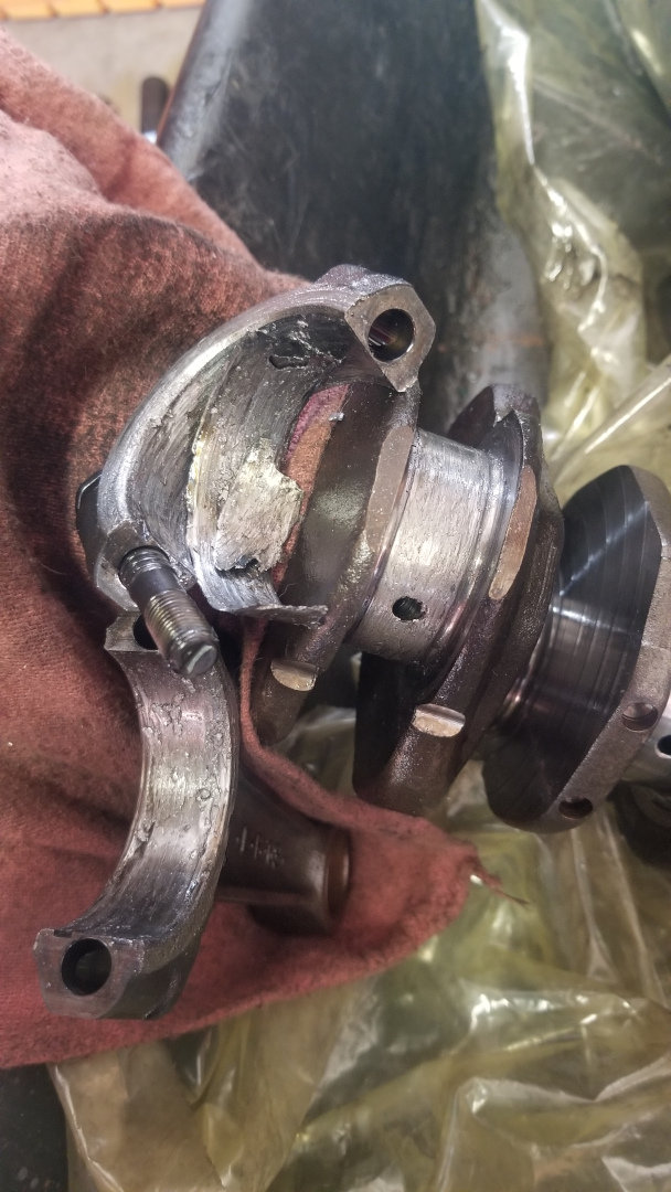

UnorganizedMechanic Posted September 20, 2020 Author Share Posted September 20, 2020 I ended up finding a nice fellow locally who sold me a used block. Unfortunately it had a rod knock, but the rest of the block is pristine. Good people out there, or just luck. But I'm going to use pieces from both to make one good one. Cannibalize and modify is my motto. Luckily it's the con rod, not the main. Time to check clearances. Up, up, and away!!! 1 Quote Link to comment Share on other sites More sharing options...

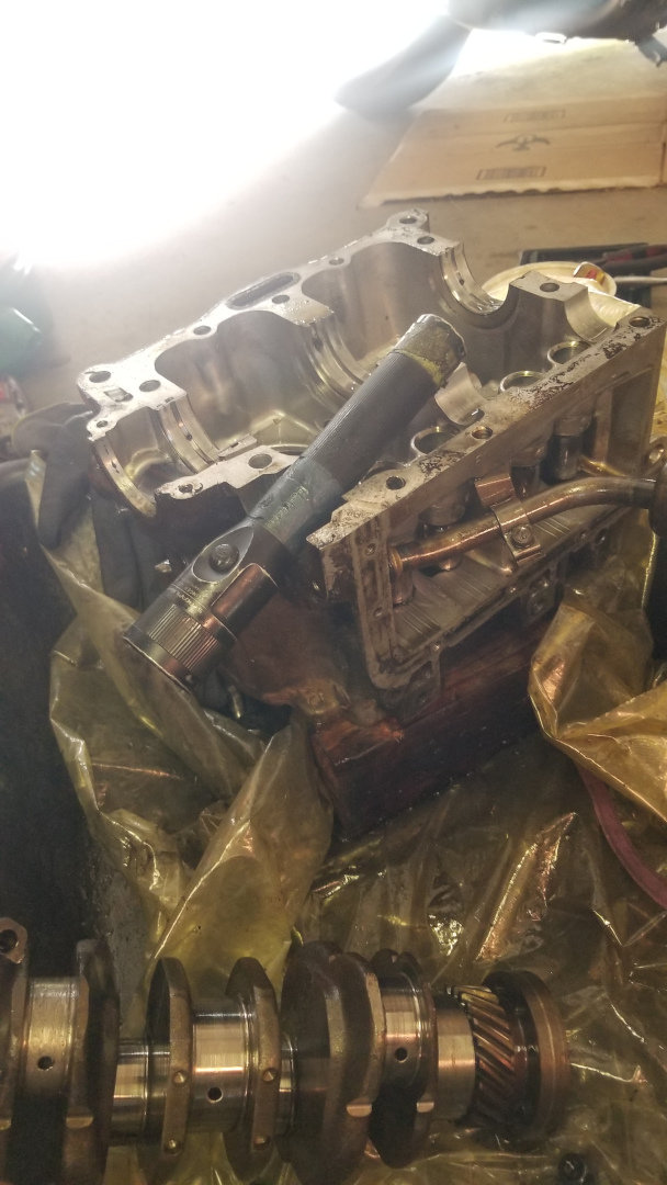

UnorganizedMechanic Posted December 22, 2020 Author Share Posted December 22, 2020 (edited) The aforementioned engine set up and rebuilt in the bay. Fingers crossed my skills have not waned over the years. Edited May 5 by UnorganizedMechanic Quote Link to comment Share on other sites More sharing options...

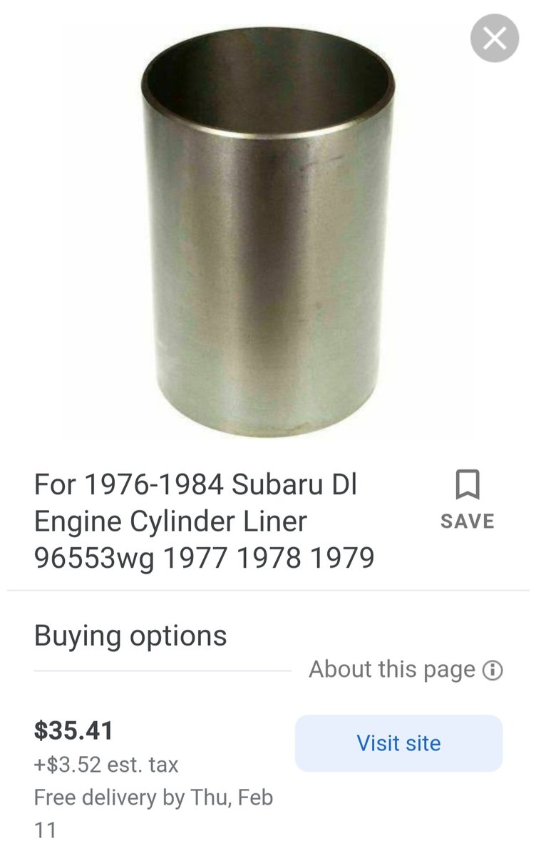

Chance Posted December 28, 2020 Share Posted December 28, 2020 I have seen sleeves for EA81s. Has anyone had one re-sleeved? Just curious. Quote Link to comment Share on other sites More sharing options...
GeneralDisorder Posted December 28, 2020 Share Posted December 28, 2020 3 hours ago, Chance said: I have seen sleeves for EA81s. Has anyone had one re-sleeved? Just curious. LOL Quote Link to comment Share on other sites More sharing options...
el_freddo Posted December 28, 2020 Share Posted December 28, 2020 6 hours ago, GeneralDisorder said: LOL So that’s a no? Quote Link to comment Share on other sites More sharing options...
Chance Posted December 28, 2020 Share Posted December 28, 2020 Most good machine shops can replace liners. Quote Link to comment Share on other sites More sharing options...
UnorganizedMechanic Posted December 29, 2020 Author Share Posted December 29, 2020 13 hours ago, Chance said: Most good machine shops can replace liners. Rockauto sells those bad boys. But the price in resleeving would equivalent to buying a new engine. Quote Link to comment Share on other sites More sharing options...
GeneralDisorder Posted December 29, 2020 Share Posted December 29, 2020 (edited) You go on ahead and ask a machinist. They will also LOL at you. You're really going to sleeve an engine for which you can no longer buy an oil pump? Talk about a stupid waste of money. WE DO sleeve EJ's for performance reasons. The cost to INSTALL and machine for the sleeves (not the cost of the sleeves or the block itself) is about $3,000 GD Edited December 29, 2020 by GeneralDisorder 2 Quote Link to comment Share on other sites More sharing options...
Chance Posted December 29, 2020 Share Posted December 29, 2020 So the answer is yes, but the machine cost is high. The machinists I know don't LOL. Quote Link to comment Share on other sites More sharing options...
