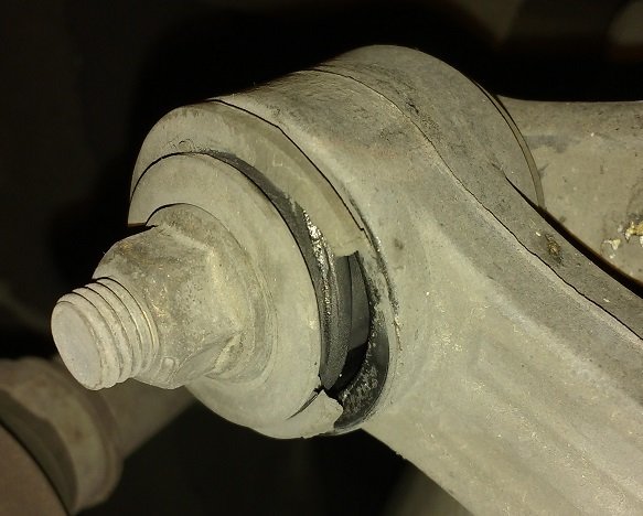

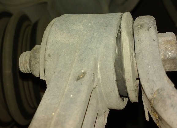

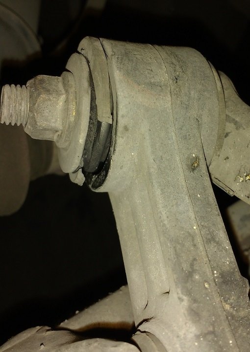

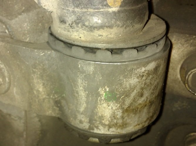

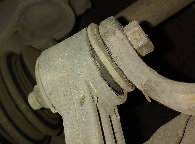

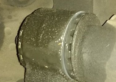

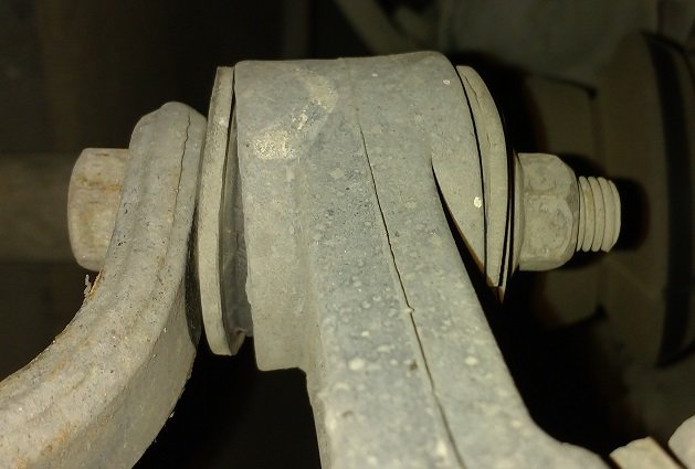

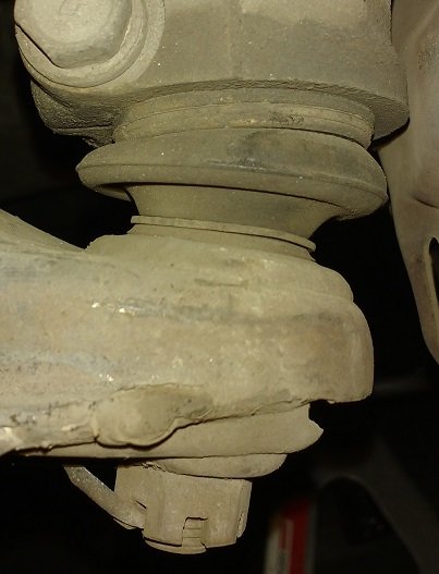

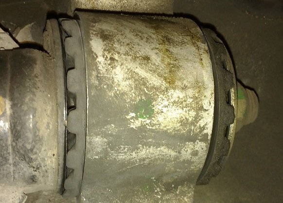

Thanks for your help guys.  Photos of my control arm bushings and end links are below.

Clunking is frequently sway bar related, usually end links, but sometimes bushings as well. Super easy to tell....just disconnect one link, that will unload the bar across that axle and the noise should go away. If not, look elsewhere.
That rear control arm bushing is fluid filled, so the fluid is likely coming out of the bushing, and will likely only get worse. I believe those can be replaced independently from the control arm (it's certainly possible, I'm not sure if they're available seperately).

Also unhook both endlinks and shake the swaybar.  If the sway bushings are worn they'll drop and rattle.  Just replace the endlinks now, you can do it with the car on the ground and some box wrenches.
The rear control arm bushing could leak, but they rarely go bad.  The smaller front one goes bad long before the rear one does.  Pry on it with a screwdriver, if you can move it easily with a hand screwdriver it's bad.

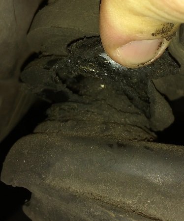

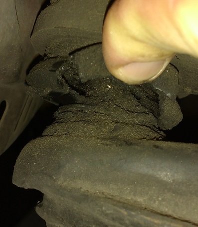

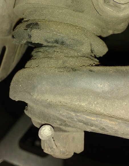

I did a more thorough inspection tonight and took off the wheels.  In addition to the leaking rear control arm bushing, I found a bad ball joint and end link.  Two pictures of the end link and three of the ball joint are below, plus a picture of my good ball joint.  I also think all four of my rear link bushings are going bad in the rear suspension. I'll put pictures of that in a separate comment below.
idosubaru, I have had the car aligned a couple times in the past few years.  It drive straight.  But I did do the clutch last winter, so I might've disconnected alignment parts when I disconnected the half shafts.  I also haven't had an alignment since I changed the rear struts.   The tires are 4.5 years old with 40k miles on them.  I was hoping to get more use out of them, but would prefer to get alignment and tires done at the same time.  I might settle for having the alignment done after I change the suspension parts, or get new tires at the same time.  Haven't decided.
I pulled and pushed both tie rod ends; zero play.  Didn't need to do the lever test; I was able to visually identify the damaged parts.  See the photos below.  Thank you for your advice on the OEM Subaru parts; I won't change the good ball joint.
numbchux you blew my mind, so those control arm bushings do have some greasy liquid in them!  So that one is bad and needs to be changed as well.  It is on my list.
brus brother not likely, pretty sure I changed my strut top mounts when I did the struts.  but I will keep it in mind if the noise persists after changing the parts which I can visually confirm have failed.
nvu I will be replacing both end links in light of this most recent inspection.  I am as surprised as you are about the control arm rear bushing; the smaller front ones looked okay.

Quote out OEM Ball joints (don't forget, they don't come with castle nut, cotter pin, and pinch bolt). I've had pretty poor luck with aftermarket ones and I think the OEM ones are pretty reasonable. And wrecked knuckles changing them.
The nails in place of cotter pins would likely indicate an aftermarket ball joint, so keep an eye on them.

ball joints can function fine with torn boots, OEM units usually do and take a long time to develop any symptoms, they're very robust.  that being said - of course replace it because dirt is just going to keep getting in there and degrading the joint.  but it isn't necessarily a dead ringer for the issues you're chasing.
definitely use OEM balljoints.  subaru ball joints are awesome, robust, and never fail.  can't say that about others and that is one part that can be catastrophic if it fails.  low chances but for $50 or less it's not the place to save a buck when you're already doing $500-$1,000 of labor savings on your own.

Thanks for the tip on the ball joint.  I suspect it is still functioning more or less correctly.  The noise so far hardly qualifies as a nuisance, and there are no driveability issues. Ball joint is relatively cheap from the dealer so I will get it for sure.  About dealership parts, I know some are low quality.  For example, their blue oil filters are made by Fram and crap, as you can confirm here:

OEM ball joints are $41.50.  So even a good brand like Moog didn't do it for you?  That one is 24 before tax, so I guess the dealer part isn't that much more.  The rear link (rear control arm) bushings are $13 each, so $52 total.  Not bad either.  But the front rear control arm bushing is a sealed unit complete with mounting bracket, and costs $117.  I think I might just go with an OEM junk yard control arm bushing in that case, on a car that looks like it had fewer miles.
I think the nail was me when I mistakenly removed then reinstalled that nut during the shock replacement job.  Maybe I overtorqued the nut.  Maybe I messed with the alignment.  The position of the ball joint thread shank and the nut affects alignment, right?  I'll get it redone done when I replace my tires later.

Almost all Subaru OEM engine and a mechanical parts are superior or excellent quality.  Oil filter is about the only exception for a daily driver NA Subaru.
moog are fine way more times than not, but they’re not OEM quality. The boot is of poorer design, metal more prone to rust, and thus I assume (though I have no data for it) lesser in other ways too.  I’d install one for someone if they want but Ill avoid them in my subarus.  It’s not like it needs to last another almost 20 years like the original did.
