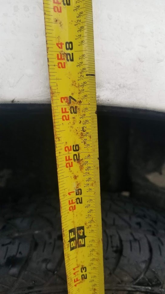

Rear Springs and Struts
I ordered from rock auto as they have clearance on the struts and the springs!
I used API 270470595 coil springs and Monroe 71352 struts. Total was $82 shipped!

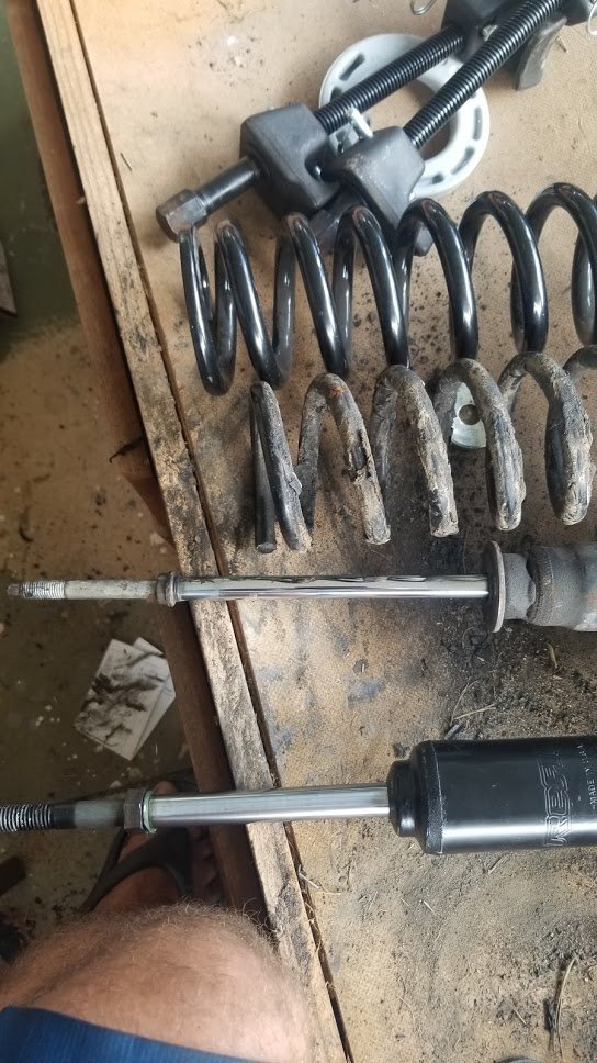

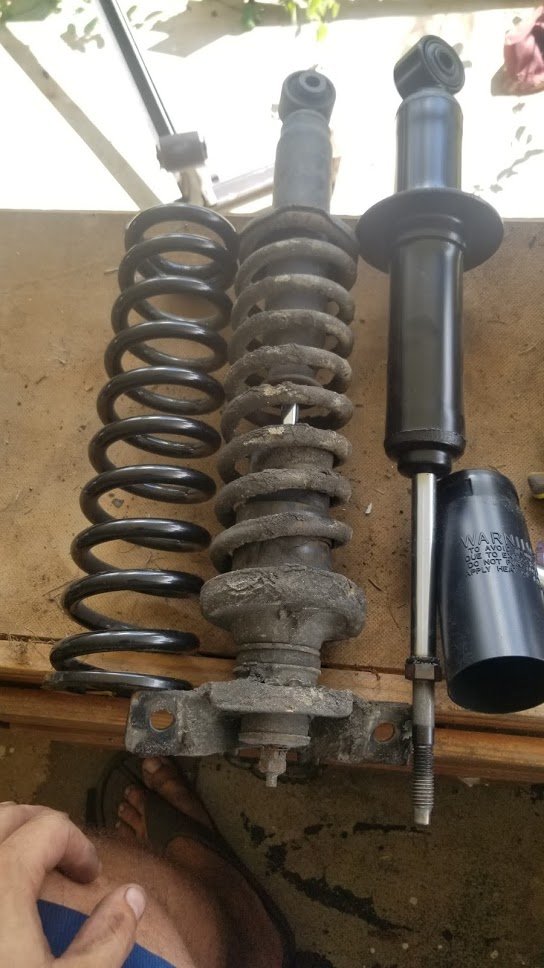

My only issue was the Monroe struts come with a cover for the rod. It has a metal washer to hold it on the top of the strut rod. The problem is this washer is larger than the relief in the Subaru cap. This causes you to be unable to install the top bushings. I omitted the cover, and ordered some generic ones. I initially thought the spring was too long, and cut one. I did test the second without cut just to see how much I lost.
You can see the cover on the right:
Stock vs Uncut and Struts:

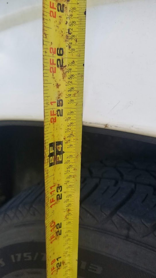

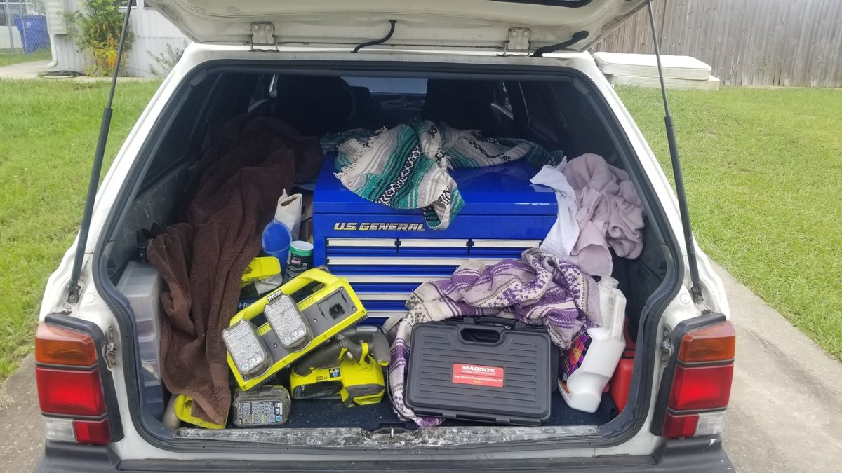

My wagon started with the right touching the bump stop due to my tools in the back.
Numbers:

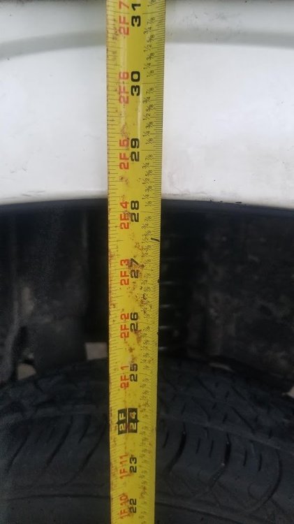

  • 24.5" Before
  • 27" Cut
  • 28.25" Uncut
Stock:
Cut spring:
Uncut:
