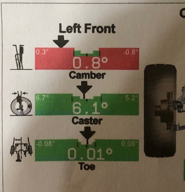

idosubaru Posted October 25, 2020 Share Posted October 25, 2020 (edited) 2008 Legacy. Shop couldn’t dial camber in on the front left. It was 0.7 off before and 0.8 after. So it got worse? They said new struts would fix it. I thought that shouldn’t matter and if it did it would make this get worse, like lifting a Subaru pushes the top of the tire out. Edited October 25, 2020 by idosubaru Quote Link to comment Share on other sites More sharing options...

idosubaru Posted October 25, 2020 Author Share Posted October 25, 2020 4 hours ago, Rampage said: The top adjustment bolt should move it Plus on Minus 1.75 Degrees. Did they say what range the adjustment goes from and to? All they said was the struts looked good but it needed new struts. That's it. I don't think there are any issues with strut/frame etc. But I have new struts already to install so I'll check. This shop did my Tribeca years ago and said "There's no camber bolt on Subarus", which wasn't surprising as it's in an area of Ohio that had zero Subaru's 10 years ago (now they're everywhere). I described the top lower strut camber bolt to them. They asked me to drop it off another day and they fixed it. I'm wondering if they did the same thing again, that's just really hard to believe. I didn't ask due to the circumstances yesterday but they have an "alignment" warranty or something where they'll align it again if i want. I'll take it in again after I do the struts. Quote Link to comment Share on other sites More sharing options...

Numbchux Posted October 26, 2020 Share Posted October 26, 2020 .8 degrees would probably require an inch of movement at the top mount....you would have other symptoms... If it's out of range of the camber adjustment, then something is bent. Control arm would be noticeably buckled before it would cause that much of a difference. Knuckle is far stronger than the strut. There are aftermarket camber bolts that can be used, either to replace the factory one, or in addition to (replace the lower bolt). Or, try a new strut. Quote Link to comment Share on other sites More sharing options...
idosubaru Posted October 26, 2020 Author Share Posted October 26, 2020 16 minutes ago, Numbchux said: .8 degrees would probably require an inch of movement at the top mount....you would have other symptoms... If it's out of range of the camber adjustment, then something is bent. Control arm would be noticeably buckled before it would cause that much of a difference. Knuckle is far stronger than the strut. There are aftermarket camber bolts that can be used, either to replace the factory one, or in addition to (replace the lower bolt). Or, try a new strut. Was hoping you'd chime in! Are camber bolts typically close to their limits on range of adjustment? New struts in my garage so I'll check that stuff when I install. I had the struts off in the summer, damage seems unlikely but definitely will check those things. I've repaired bent struts and control arms so I have some general familiarity with those. Quote Link to comment Share on other sites More sharing options...
Numbchux Posted October 26, 2020 Share Posted October 26, 2020 Right at the pivot between strut and knuckle wouldn't take much to be off by a degree, so you may not be able to spot it, but it might be fixed with new struts. The parts counter at the Subaru dealership where I worked was right in front of the alignment rack, it wasn't uncommon for techs to ask one of us to come out and pull on a tire while they tightened the bolts to get the camber in range, because the camber bolts couldn't quite get it there. But it was always pulling the camber towards the positive, as the stock stuff was too far negative. Quote Link to comment Share on other sites More sharing options...
