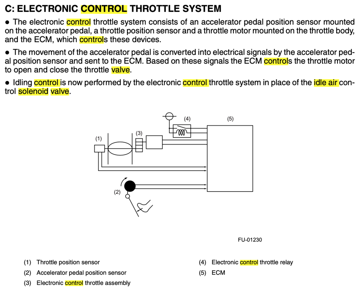

Where is the IAC? It's not listed in my FSM.  Idle control appears to be electronic, controlled by the ECM.

It’s always very close to the throttle body, on those I think it’s attached right on top drivers side of the throttle body. Small plunger, two bolts.  There’s a couple varieties over the years, I could be confused.

Imprezas had dbw in '07, not sure when legacy outback got it. dbw does not have IACV, the ecu holds the throttle open for idle air or something I think.

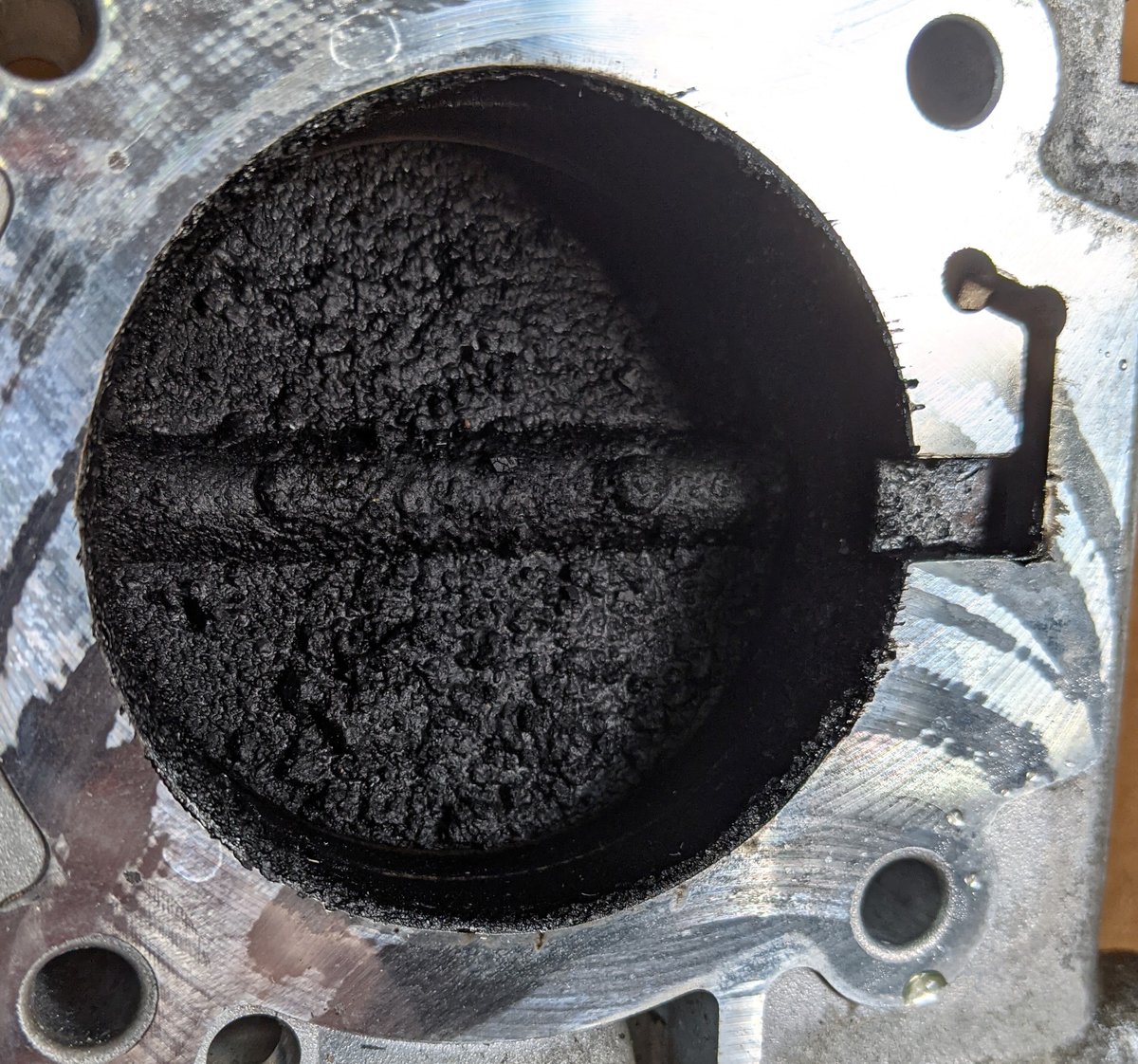

Today I cleaned the throttle body, see pic of thick gunk on intake side of the throttle blade after separating the throttle body from the intake. Probably saved me from a future problem. Did the idle relearn procedure as written, ran rough as before, like its missing, as the idle slowed down as the engine warmed up. Didn't touch the gas at all, per procedure. Didn't stall. On the 5 minute idle, got misfire codes in cylinders 1,2 and 3. With it running rough/misfiring, I'm assuming that the ECM relearned the idle as best as it can with another problem on board. I may have to repeat this step. So for now, its back to the troubleshooting chart above. I recall the previous occasions of stalling happened after I touched the gas, which dropped the rpm's. Probably some time late next week I'll start swapping parts from the 2008 auto, starting with the MAF and manifold pressure sensor because they are easier to change, and the coil pack.  I have a freeze frame from my new code reader that doesn't appear like anything is obviously broken, to my untrained eye.
That’s a crazy amount of gunk on that throttle body!
Have you tried running a can of upper engine cleaner through the engine? Follow the instructions to a T and keep the revs up as you spray the remainder of the bottle in.
I’d say you have some very dirty intake valves - the back side of them. This could be causing issues with the air fuel mixture entering the cylinder.

yeah, I can't help wondering what issue has been going on to lead to that? Bad PCV valve? or bad temp sensor or knock sensor or ??? throwing off the fueling/ignition for a long time???
wonder what the valves look like?
maybe that SeaFoam spray with the u-turn nozzle could help here?
