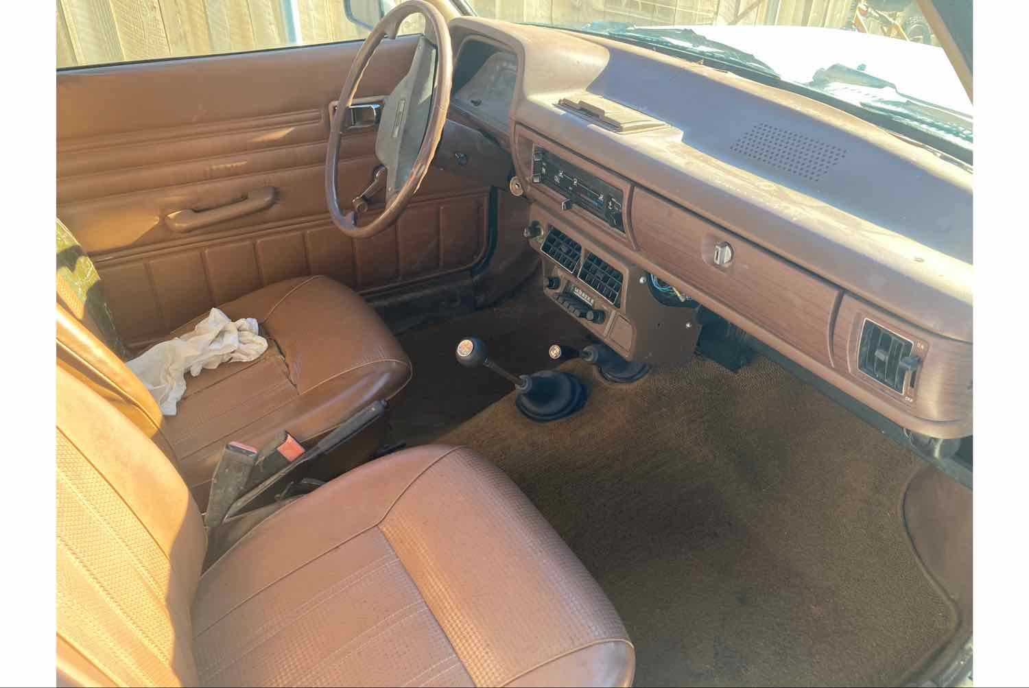

80BratGage 2 Posted February 11 Thought I’d add some photos I was able to resize . Share this post Link to post Share on other sites
moosens 510 Posted February 11 My parts manual does not show the drain plug. If it does and I’m not seeing it , they still don’t list any size within the Part Name column where sizes are always shown when applicable. Share this post Link to post Share on other sites
moosens 510 Posted February 11 Looks nice! From here that looks like an uncracked dashboard. If so you want to baby it. Share this post Link to post Share on other sites
80BratGage 2 Posted February 11 Thanks for looking . Still haven’t made it to Tacoma screw but will tomorrow most likely. Yeah the dash is in great shape. Was pleasantly surprised how well the interior is Share this post Link to post Share on other sites
