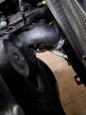

Finished the radiator install. And despite what people said online, the lower hose and upper hoses were a nightmare to get sorted without kinks. The bottom hose I ended up using a 1 1/4 steel pip insert plus two other hoses to get the right angles without kinks. Doesn't appear to leak - so at least that is actually sorted.

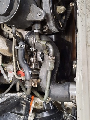

Lastly I got the power steering lines in but they are too long to flow naturally with the rest of the engine cavity. I am going to get these shortened correct at a shop in the future after the car is sorted enough to make real journeys.

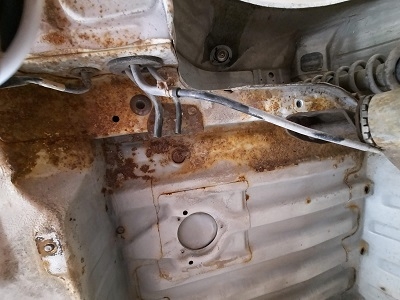

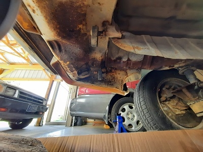

-Battery tray - I cut out the old one because of rust, I have a small hole to patch in the wheel well too
-Other rust repair - There is a small hole under the car, might have this professionally done (doubtful but we will see)

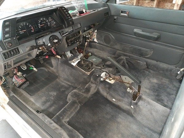

Well I decided to update here the progress I made up to this weekend. Quite a few things have been crossed off the list.

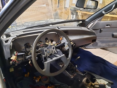

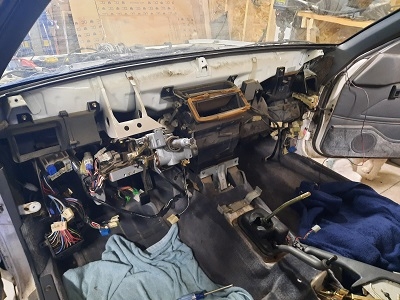

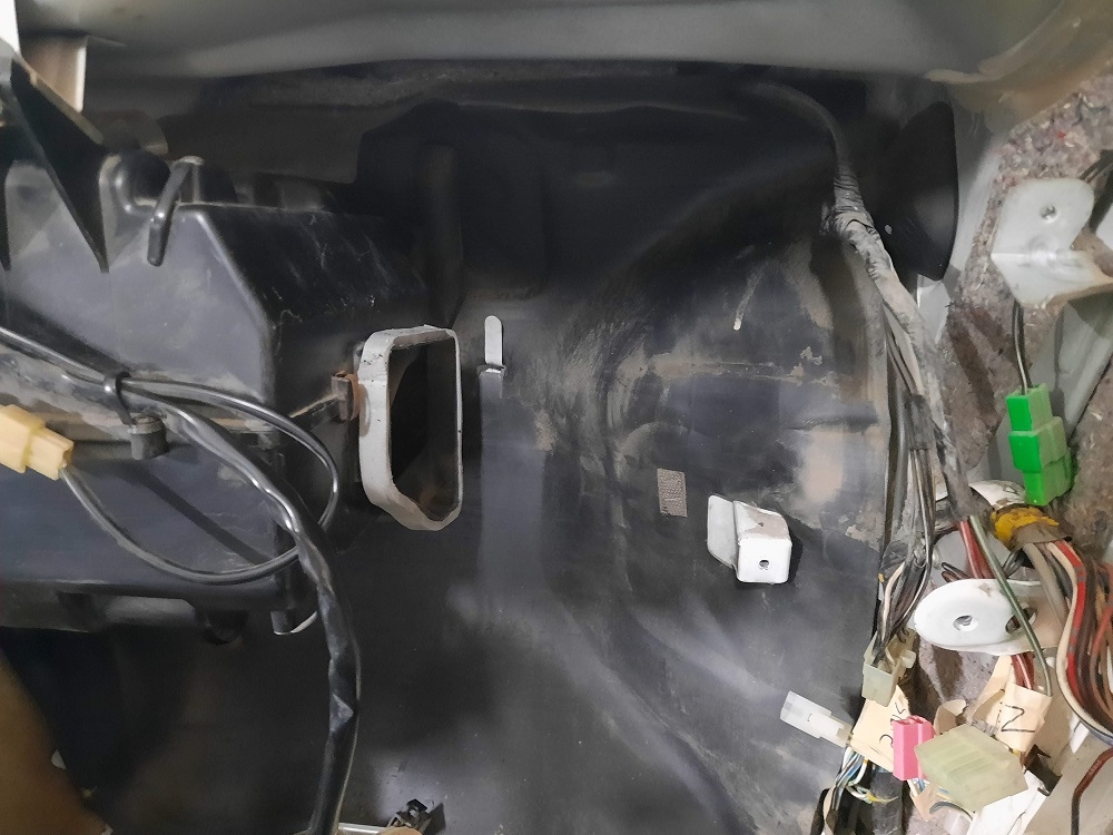

1) I removed the dash, heater core, and blower motor. I cleaned everything and all the vents, there was quite a lot of dust and debris in the system and I really wanted to make sure I wasn't going to have any problems with the ventilations system. I mentioned at the start of this forum that the car was abandoned for 12 (? ish) years outside, and there has been some evidence of mice so I really wanted to make sure everything was clean for that reason.
Edited by 1980ea71Brat
2) I removed the carpet and had the heater core pressure tested and flushed. They found nothing wrong with the heater core, and I learned that the unit is entire copper- no plastic tanks. I also had to replace the insulation that isolates the heater core in the box, stove threaded sealing material worked really well for this and has a heat rating well beyond what the heater core will see.
I scrubbed and cleaned the carpets with an extractor in an attempt to remove any stains or residual smells. I also found a hidden pack of unopened cigarettes from the 1980's. So clearly this had been a smokers car at some point (no surprise since its from Montanaimage.jpeg.1c929839d05baacfb81532b715595fcb.jpeg).

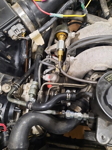

3) and 4) I got my power steering lines professionally shortened and I got my oil pressure sending unit plumbed for the 1987 oil pressure gauge. Each cost me about $50. I should mention the heater core cleaning and testing cost me about $70. Still all worth it in my opinion. The power steering lines aren't perfect, but good enough and now they are out of the way of the air box. I wanted to keep the original air box and stuff for now, maybe one day I will worry about changing it.
I've never been much a believe in the 'cone filter' upgrades. *Most* intake systems are designed to be extremely efficient from the factory.image.jpeg.a25c6f0f8d6deab3d662c274cd35ca0b.jpeg

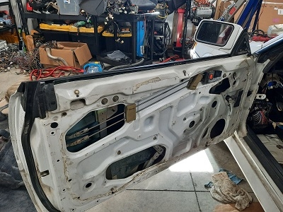

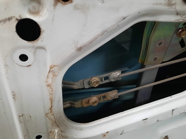

5) I fixed my door. If your door only opens from the outside latch, but not from the inside latch, the lever is out of adjustment. In the photo below, the lower of the two levers controls the action from the door handle. All I had to do was loosen the nut, pull it more taught, and retighten the nut. Plenty of room for adjustment there. I didn't get a picture of it, but I removed 80% of the old vapor barrier sealant and replaced it. The vapor barrier was in terrific shape, and I think I am the first person to have removed the door card. Using proper tools is extremely important to not breaking any tabs.

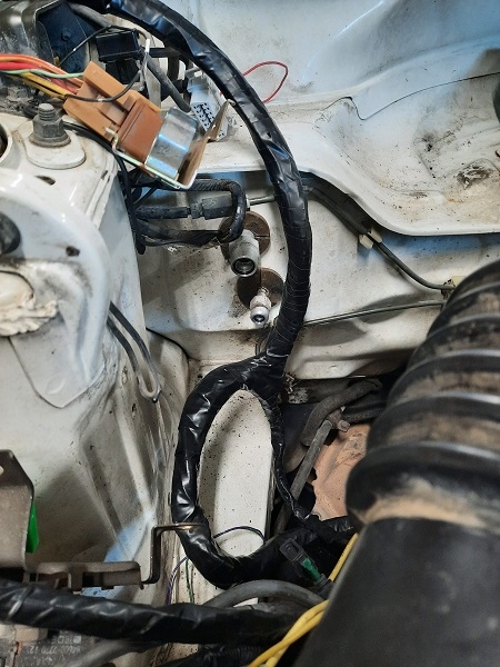

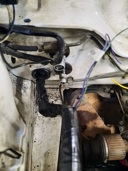

6) Last item, but not really finished yet. I decided I am going to cut a hole in the fire wall. Yeah, I cringed when I first came up with the idea. But the fact is, this RX is not an original car. It has a few rust damaged spots that need to be repaired (pics on those later...) and its got an EJ22. The paint is in terrible shape, and the interior needs some reupholstering. I'm not going through the fender for a rather selfish reason... the body kit. On a normal EA81 or EA82 car, you don't have a body kit in the way of removing the fenders. On my car, I have to fully remove the front and side body kits in order to get the fender to separate correctly. I don't want to do that. I'm worried it won't look the same or be perfectly level if I have to reattach it myself.
So hole in the fire wall it is. I looked around this is the spot I chose:
I am going to put a 1.5 inch hole to the left of the A/C lines, and use a grommet to make it look factory. I am going to store the ECU in the foot well on the passenger side, just like the EJ22 was done originally. There looks to be enough room to hide the main power loom behind the blower tube to A/C tubing:image.jpeg.585495e02f60b2ceb89c439567e912a5.jpeg

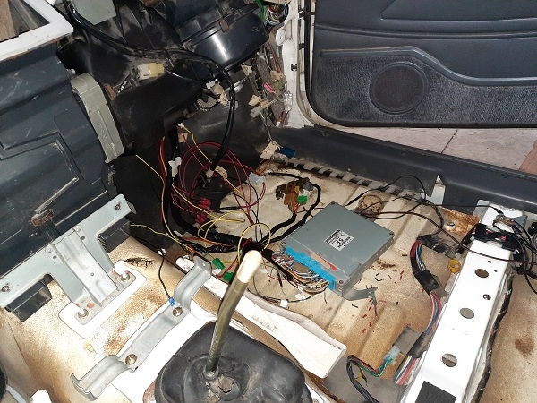

1) Cut a factory looking hole in the fire wall. Relocate the ECU to the passenger foot well.

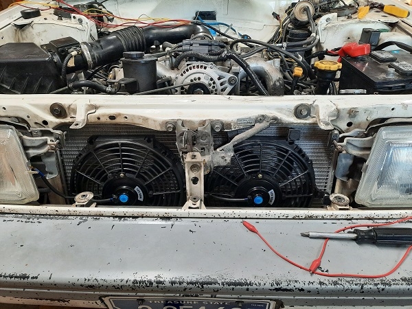

4) Wire the radiator fans. THE FANS ARE COMING EARLY - I am supposed to get my 2 10" fans today from Fedex, and I bought some relays just incase they do. So I am going to mount the fans this weekend, test the relays, and finalize that part of the ECU wiring.

6) Reinstall the dash

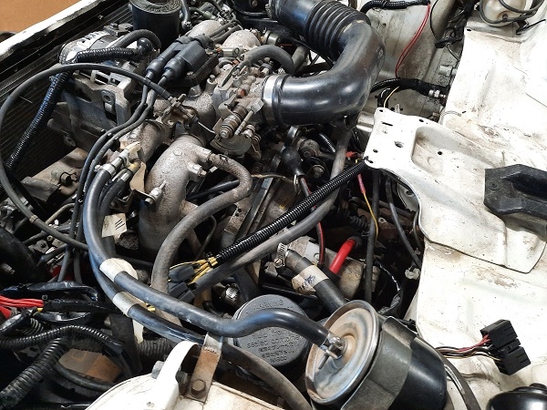

I still don’t understand why your PS lines are so messy - I use the EJ hoses from the pump to the rack, but over here we don’t have that funky block to hard lines setup as our rack input is on the right side of the car so the PS lines go straight into it.
Everything else looks good to me. With the firewall hole, you couldn’t route the wiring through the guard with the length you had in your cutdown loom?
Cheers
Bennie
I ended up using the EA82T power steering lines, for some reason the EJ22 lines off the 96 were not going to line up correctly at all. Could be a US spec deal, or maybe its a different rack in the RX. The EA82T weren't perfect but with that little bit of fabrication it was mostly a straight shot.
Not sure what you mean by guard, but the loom itself was pretty small. Here's a shot of what the hole looked like:image.jpeg.075a249412b5fcdd42c1623085466767.jpeg
After the loom was mostly installed:
Here's my loom for the oil pressure, coolant temp, switched power, constant power, and tach. Extra fuses for the relays.
The hole is a little messy, I used a lot of oil to help the hole saw get through it. But once its cleaned up, it fits really nice.
Here's where most of my wire sits out, including the fan wiring. Out of the way, I forgot to throw the starter wire into the power loom so it sticks out a bit lol. I was tired after ~8 hours of wiring.
Here's the fans I went with. Not sure on the brand, but two 10' pushers off of amazon. $50 each was right for me. Wiring wasn't sorted yet at this point.
Here's after I finished all of the endless splicing:

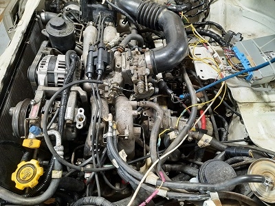

Appreciate it Bennie, you might be the only one reading this progress blog and I appreciate you lol. Once I am done, I might save this story for my daughter when she grows up.
So at this point, I have driven the car maybe 20 miles and things are mostly working correctly. Not overheating, low oil pressure at idol, but that's okay. Used engine that I did absolutely nothing to before putting it into the RX. It won't be the permanent engine, just a place holder to get everything else around it sorted.
Part of the motivation for this project was I had parts piling up for 3-4 years in the garage, and I had completely run out of space. Now that this is mostly finished, I can finally get rid of all my old EA82T parts in confidence and not have to worry so much about needing them. The garage is making a recovery.
Issues I need to sort out with the swap still:
- IAC P0505 Idle Air Control valve error code is my only engine code. The car seems to be running fine and idling fine, so I'm not sure how much time I am going to invest into fixing this

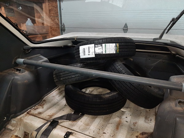

Get the pitch stopper rod done before you start driving it, you’ll be surprised how much the engine moves without it! This can cause other issues such as fan belt or pulleys making contact with the rad fans. From memory others report odd issues when driving.

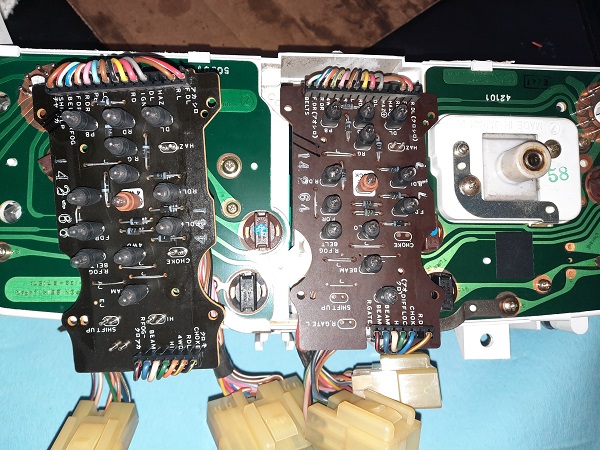

Aye - Thanks Bennie. Been looking forward to it. Its been a couple weeks so I wanted to throw up a few things that I have done/fixed.
I solved my Diff lock problem. The reason why I swapped clusters was because the gas gauge in the old RX cluster wasn't working (I did all the diag that lead to that conclusion). But what I didn't know is that the center light configurations change over the years. So the center panel on the left is from a 93 Loyale, and the one on the right is from my RX. They look mostly the same, but they are not. I swapped these out and it looks like my Diff lock light is working correctly, and the hazards lights (these were previously only blinking one side).
I also had to swap out the plastic center piece that I didnt picture here, but that made it so the lights lined up correctly. I probably could have just swapped out the gas gauge side in the RX cluster but this is ultimately what I ended up with. I also have several spare clusters and parts now for the future if anything breaks.
