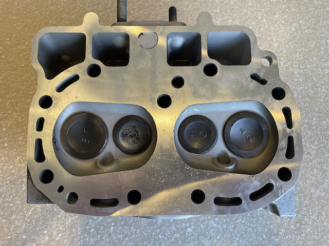

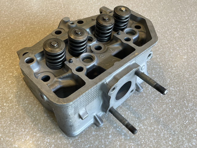

torpedo51 Posted June 21 Share Posted June 21 (edited) Hi, I'm rebuilding my EA81, and I can't seem to figure out what year it was made so that I can order accurate rebuilt parts (gasket set, bearings, etc) Its currently part of a VW bus project... I don't have any record of any prior Subaru VIN. I can try to obtain pictures of the head gasket mating surfaces, and whatever casting codes are present. I think we tried to find casting codes before, and didn't see anything definitive that linked the case to a year/make/model. Is there anything else that will help me? I have a few service manuals, but I don't see a section for "identifying" the engine. Thanks! 67752945031__5E29556E-25BA-445B-B443-537F138297CA.HEIC Edited June 21 by torpedo51 added photo Quote Link to comment Share on other sites More sharing options...

Steptoe's photos Posted June 22 Share Posted June 22 There were different standard head castings over the years and the earlier heads used slightly smaller valves.Some had what could be described as flat braces seen on the top side between central area and outer as if to brace where inlet manifold bolts on. So much of these is so common, it might be your luck to get something different. HGs the same right through EA81 carb models. Can you add a pic of the head spark plug side to a post ? Quote Link to comment Share on other sites More sharing options...
