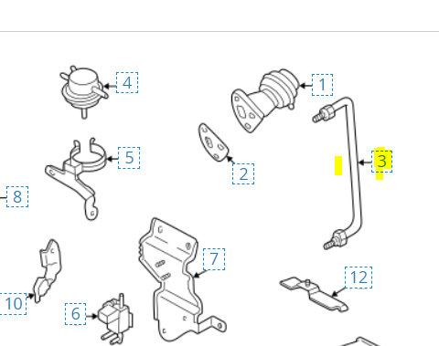

It goes from the egr valve to the cylinder HEAD.
I found it, a vertical tube about 12 inches long. Nut takes a 17mm wrench. I sprayed some PB blaster fluid on the top one as it doesn't want to turn. It's such a thin nut I'm afraid of the wrench slipping and rounding the nut corners.
They can be very tight.  I've used a tubing wrench.  The flat 6 sides work well.  In the yards a vise grip works.   Before you go to the trouble of removing it, do the troubleshooting using a hand vacuume pump to open the egr with the engine at idle.
Okay, the tubing spanner or the flare nut wrench arrived this morning and I got the tube off this afternoon. The tube was not blocked and looked rather clean. No partial blockage either.  Perhaps with all my cleaning perhaps I've solved the problem. But I would like to make sure the egr solenoid is working. Seems like I saw somewhere how to test that. Also Someone recommended testing the egr with a hand vacuum pump while the car is idling to see if the egr works.
I found a non-automotive hand vacuum pump that did the job. So at idle when I connect the hand vacuum pump to the EGR it causes the car to idle very badly and almost die. So I guess that means the EGR is working fine?  Maybe the system just needed cleaning. I'll get the car insured and take it for a 50 mile drive and see if the P0400 code comes back and see if the gas mileage is back to normal.
