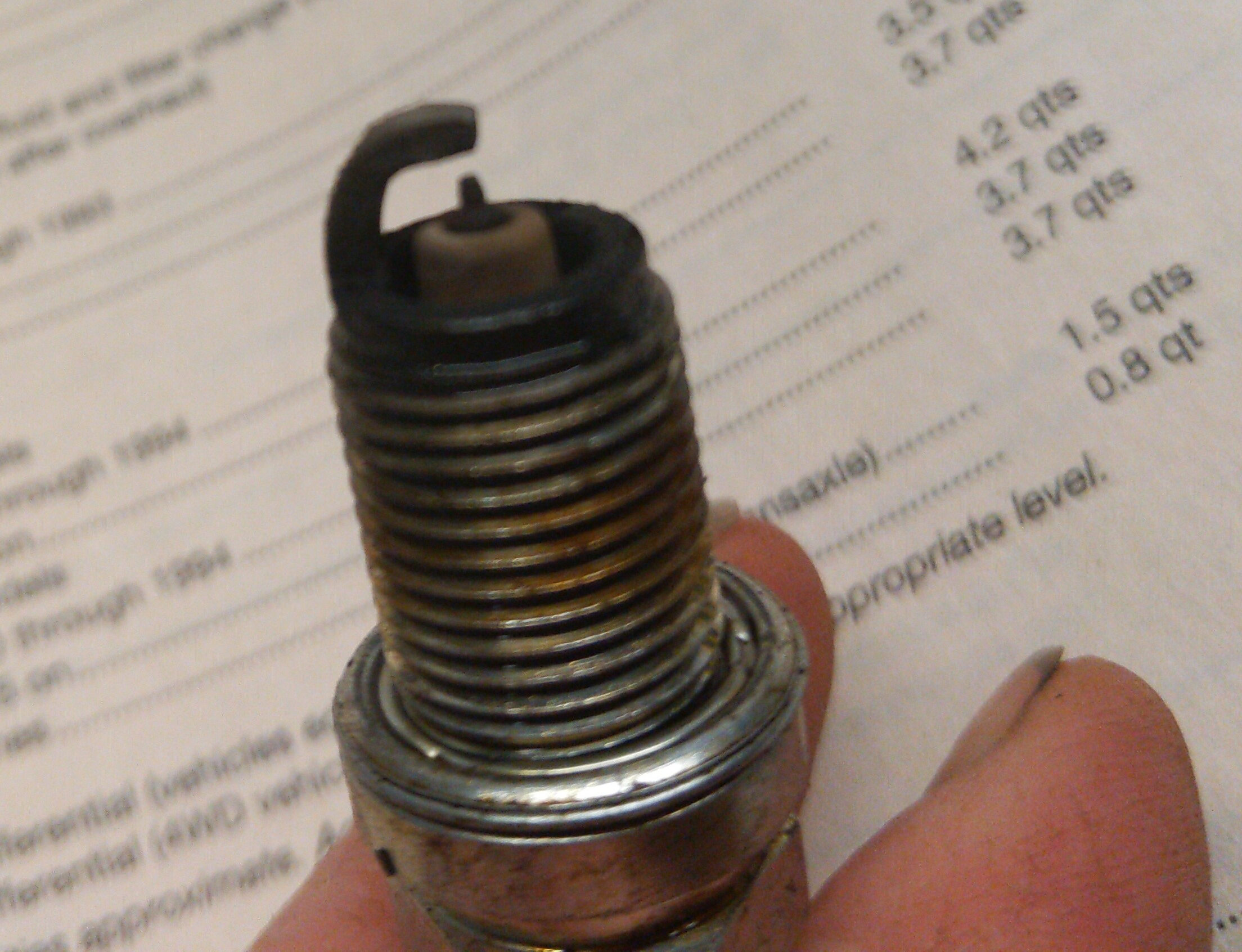

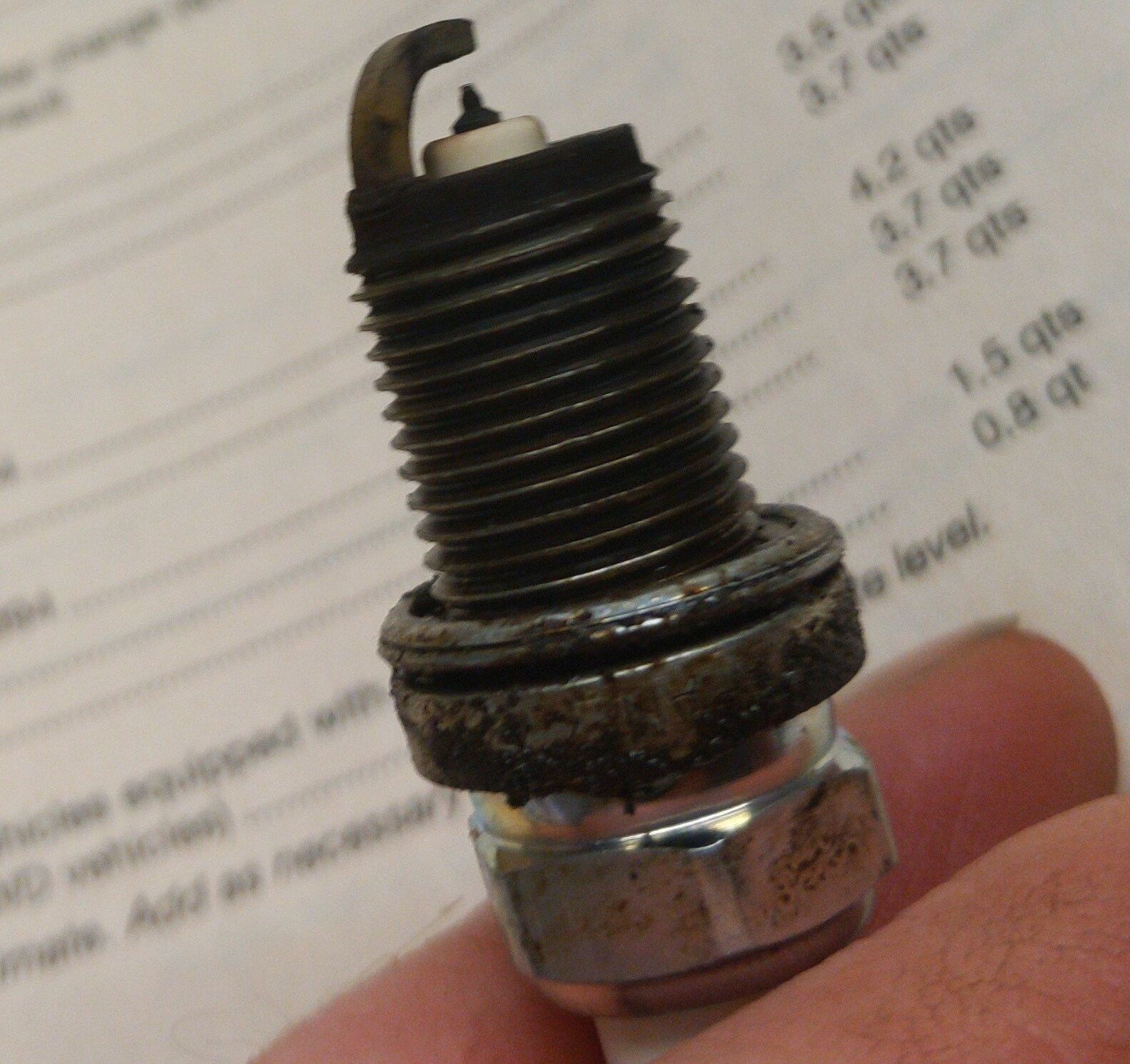

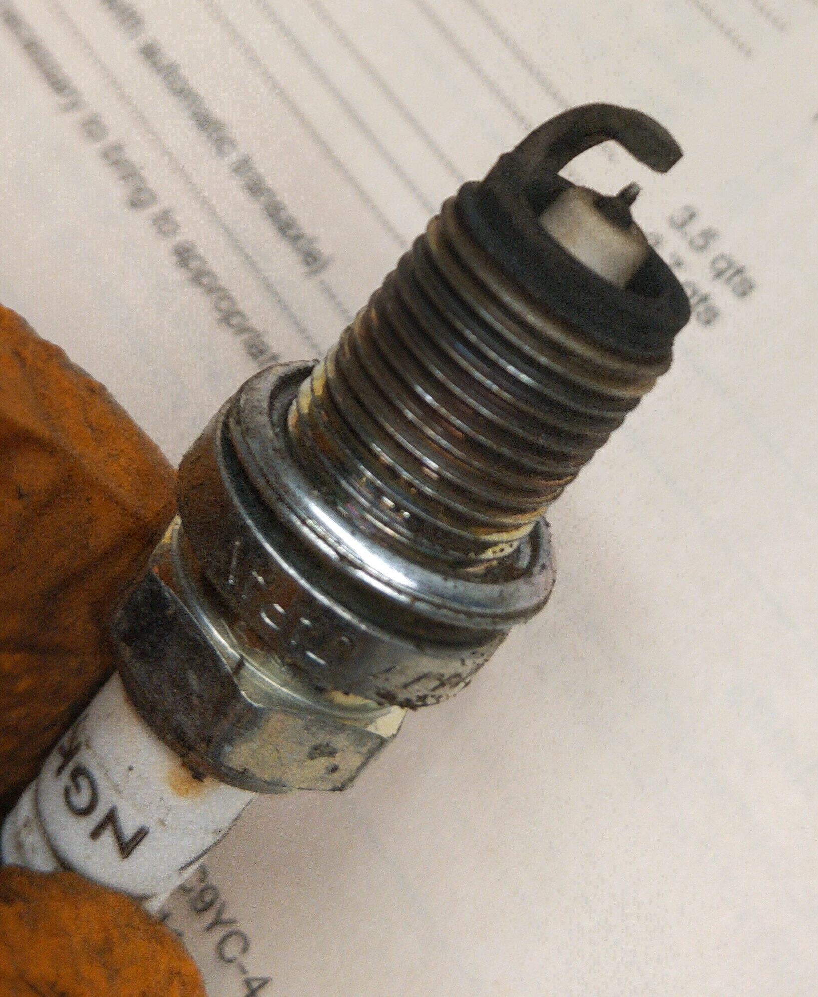

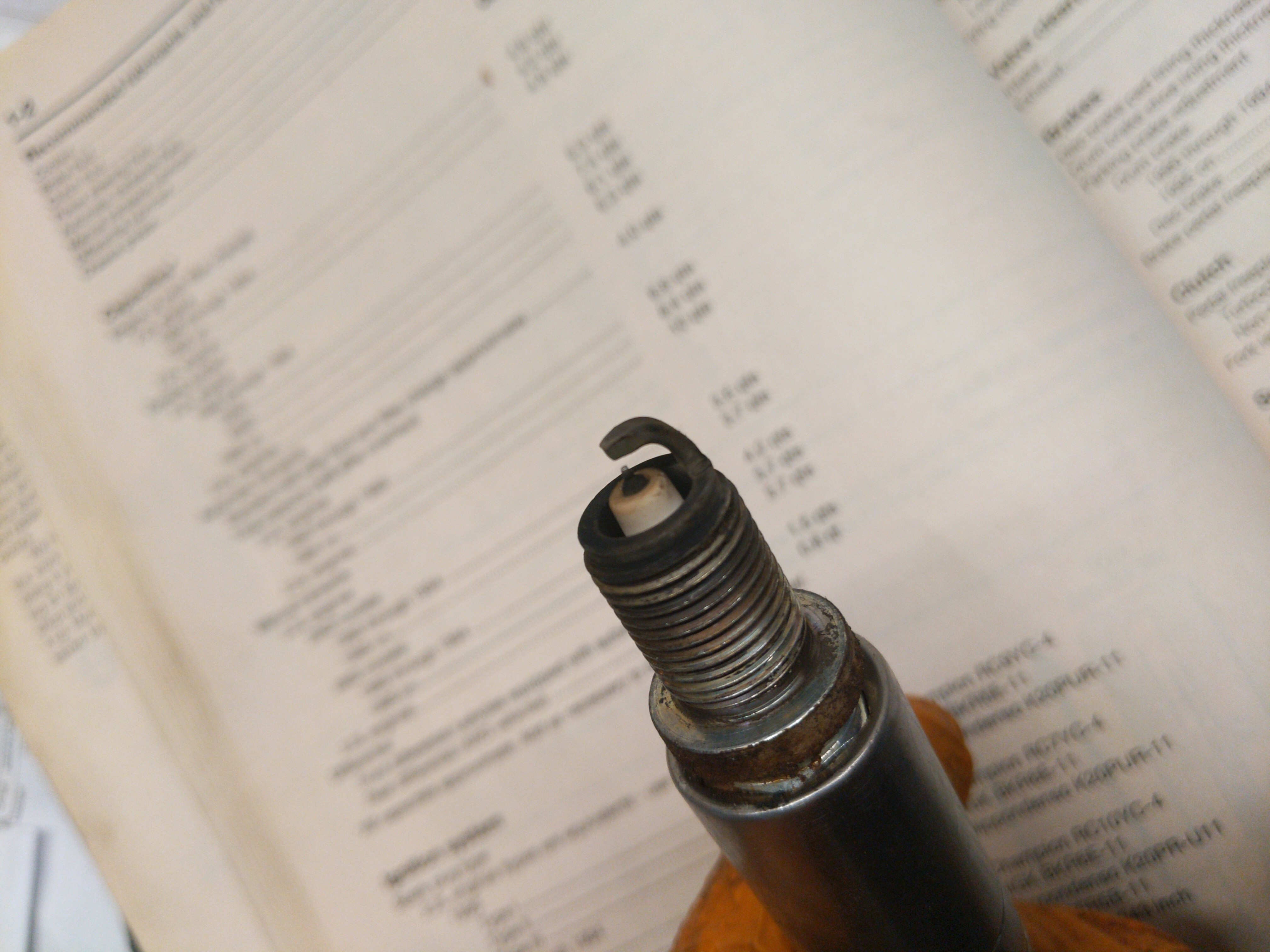

nelstomlinson Posted January 18 Author Share Posted January 18 I changed the plugs, and it's starting a lot easier: crank-crank-roar! instead of cranking for 10+ seconds. The plugs looked OK, and the gap was still barely in spec. I changed'em anyway, and it started quick and easy for the first time in a week or so. Cylinder 2 plug was a little more discolored than the other three, but none of them look like there's serious trouble. Quote Link to comment Share on other sites More sharing options...
