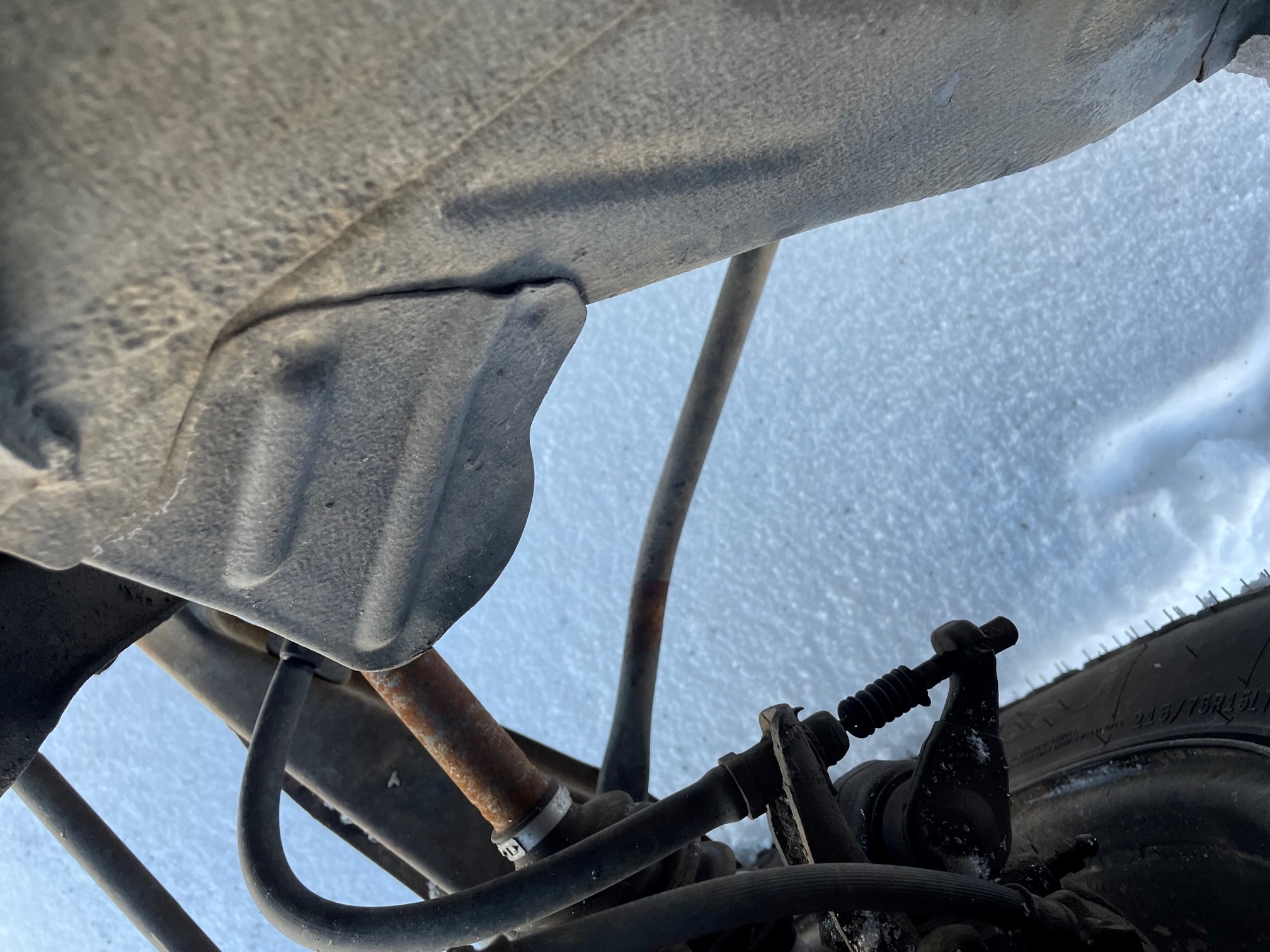

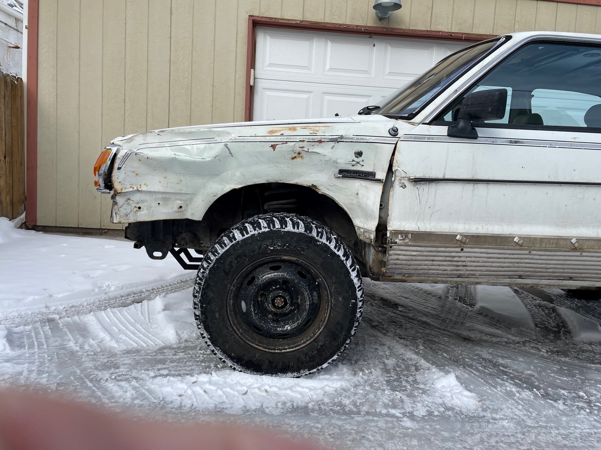

vesparex Posted January 19, 2023 Share Posted January 19, 2023 Can anyone tell me deffinetivley if the lower control arm is the same for 2wd and 4wd? My baby was involved in a hit and run last night in front of our house here in Denver and they pushed the left front wheel back, bending the left lower control arm. I have a full front clip from the same year model 2wd. Quote Link to comment Share on other sites More sharing options...
moosens Posted January 19, 2023 Share Posted January 19, 2023 They are the same. If you wanted to have some parts counter guy or gal search the part number is 7210 61000 for the Right side and 721061010 for the Left side. The link bushing I’ve actually seen lately on ebay for around $12 and it’s p/n 6211 08170 Doug Hill - DRW Bushings makes polyurethane sets for these generations. Good luck with it. You probably know already that they (old Subarus) tend to flex out and reshape well enough for another 100,000 miles or so. Done a few myself. Chain to a tree, reverse hard, etc etc Quote Link to comment Share on other sites More sharing options...
el_freddo Posted January 20, 2023 Share Posted January 20, 2023 You’ll probably find it’s the radius rod that’s bent and not the control arm, they can flex quite a bit with their suspension bush on the subframe end. Fingers crossed it’s a cheap and easy fix. I hope the scum that was responsible for this action has a date with Karma soon! Cheers Bennie Quote Link to comment Share on other sites More sharing options...
Rupart Posted January 20, 2023 Share Posted January 20, 2023 the round support rod in your pic is the radius rod, 2wd will be same. Easy fix, looks like the body work is more serious. sorry for your bad luck, hope the person is caught or is caused their repay somehow. Quote Link to comment Share on other sites More sharing options...

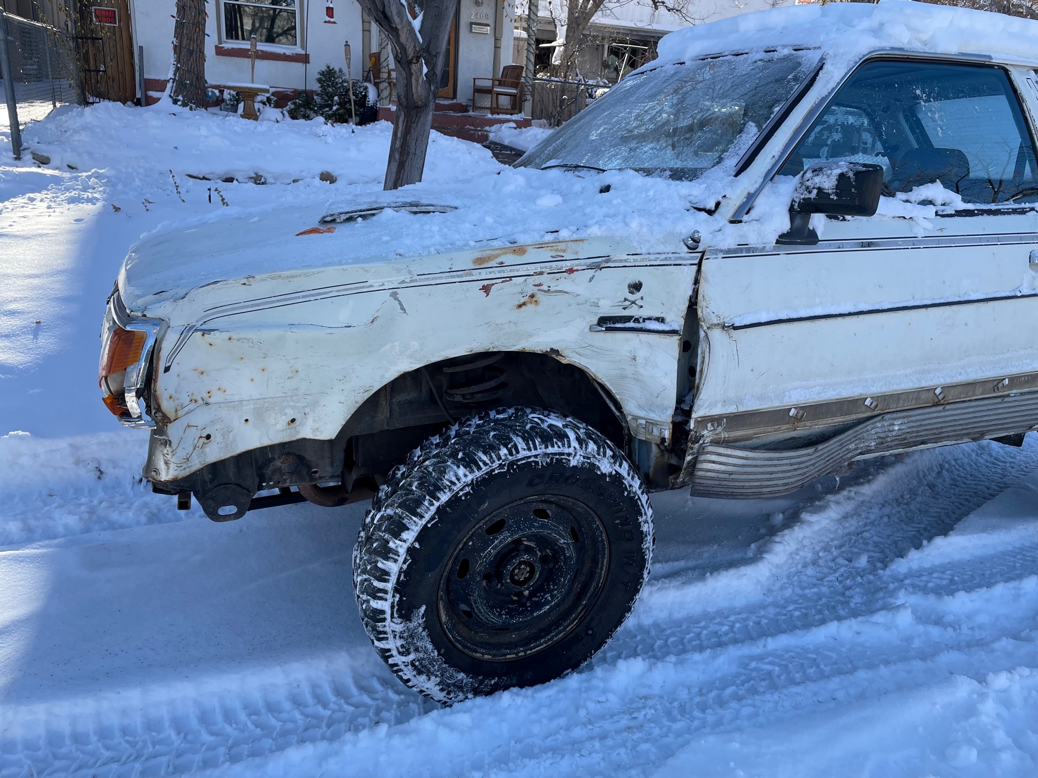

vesparex Posted January 21, 2023 Author Share Posted January 21, 2023 So it was the radius rod. It was "Z" shaped and I straightened it. Shes back to her old self. Door tirm reattached but that front fender, well, its flatened pretty well. That lower control arm only has a slight bend but as stated above, the rubber bush takes that up. Thanks everyone. She lives for another day or 3,650 more! As a follow up as I havnt posted here in a while; She is my daily here in Denver. City car by weekday and Goat on weekends. Endless fun doing donuts when we get snow and I find and empty parking lot. Quote Link to comment Share on other sites More sharing options...
