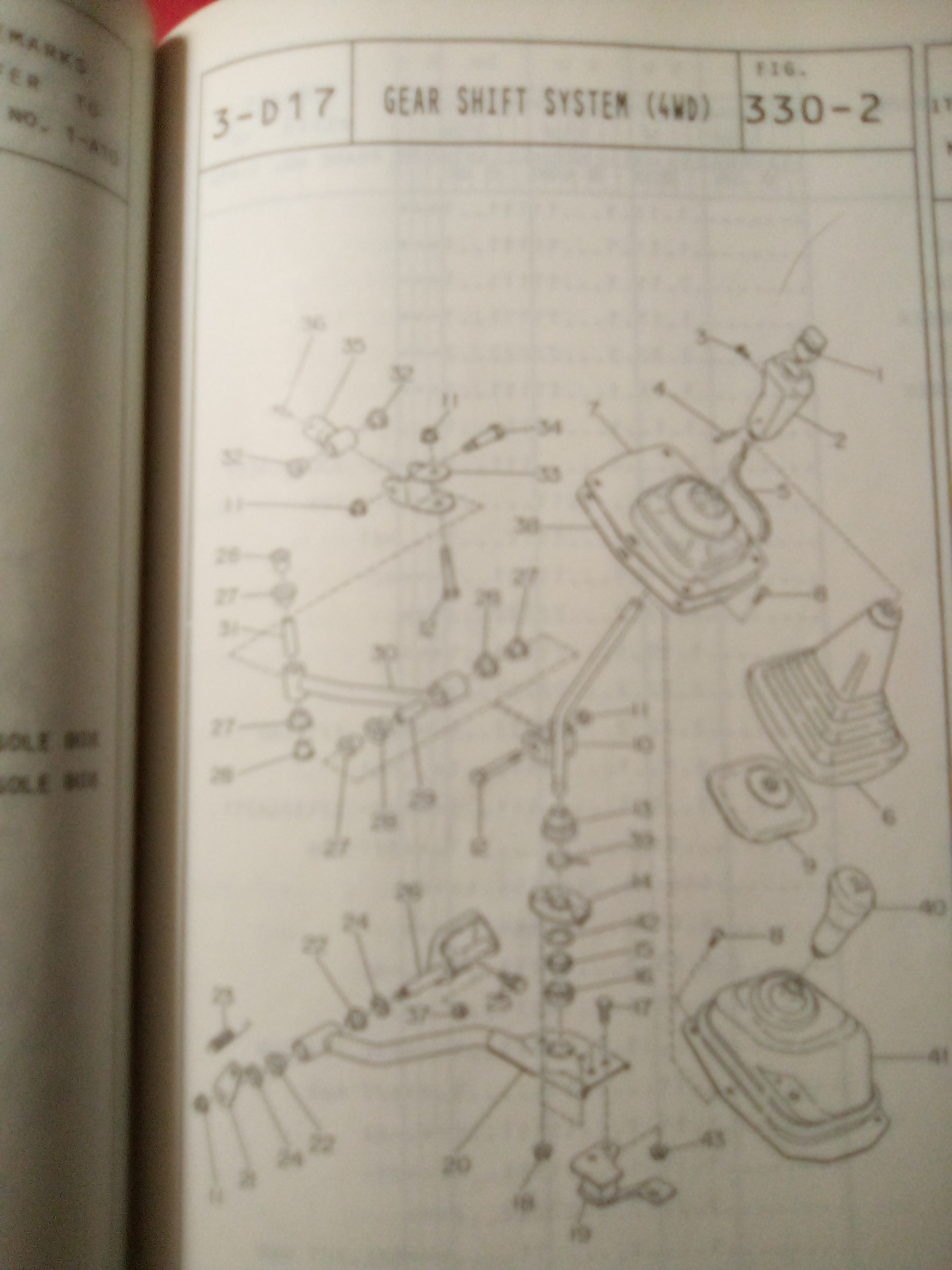

Rupart Posted April 7, 2023 Share Posted April 7, 2023 hi, the pic you show is what is a 2wd shift bracket here in usa, the 4wd bracket is a little different, going to try and post a pic from the oem parts book for 85-89 era. ea-82. page 3-D17 & 3D16 show the pic for each version. there is a rubber cushion piece that bolts to the bracket, and then to the tunnel on a stud that is said to be there, i hope mine is since i have yet to find time to install my kit yet. the 2wd & 4wd shifter bracket and the cushion mount are different from each other. i could only load the 4wd parts pic, i think it is on here. hope this a little help. Quote Link to comment Share on other sites More sharing options...
Rupart Posted April 7, 2023 Share Posted April 7, 2023 (edited) hi,. i just looked again and realized you are not showing the lower mount bracket,, what is in your pic is the actual rod that goes to the shift rod in your trans. there is another lower bracket( mounts on trans) at that shiney alum spot on your trans, then another rod that connects to it and goes back to the shift pivot cup, mounts with the 2 studs on the cup. then the rubber cushion piece also boltsto the rear of that bracket rod piece. Check the pic i posted, i think its clear enough to make out the parts, click on it to expand. Sorry , i may be wrong about your pic being 2wd parts,, i was looking at the other rod bracket, but,, both shift rod brackets and the bracket that goes on the trans are different for 2wd or 4wd, so basically you gotta have all 3 parts for a 4wd to work right, all from an ea82 setup. Edited April 7, 2023 by Rupart Quote Link to comment Share on other sites More sharing options...

Rupart Posted April 9, 2023 Share Posted April 9, 2023 (edited) hi, i see what you have there. The parts book i posted from is 86-88, #20 is the rod/bracket i had mentioned, note how it is bent to offset up and to the right at the rear of it, and the shifter cup studs go front to rear in it. Also note the front end of it with bushings, that go on a stud on bracket#26, which mounts to the trans at that shiney spot we mentioned. The rubber cushion bracket is#19, it bolts to the rear of #20,, and the long end of it is supposed to go on that tunnel stud. Edited April 9, 2023 by Rupart Quote Link to comment Share on other sites More sharing options...
Rupart Posted April 9, 2023 Share Posted April 9, 2023 ok, i just looked at my shifter set, the upright flanges that are in your 2nd pic are the pivot flanges for the ea82 hi-lo shift lever mount,, you can remove that,, it is no longer used. the other tab sticking out the back, is one side of the rubber sandwich bracket,, the missing rubber and longer side are gone,, the longer tab is what would go to the tunnel stud. by taking off the orig 5spd hi lo mount tabs allows the main rod to go up a good bit. i tried to buy a new rubber bracket from subaru, "discontinued", also not able to find one in aftermarket parts, so no advise there. the rubber part is about 1 inch thick, and the lower tab is longer and 2 bends, and a hole in the end to reach the tunnel stud. Looks just like #19 on the parts page pic. Quote Link to comment Share on other sites More sharing options...
