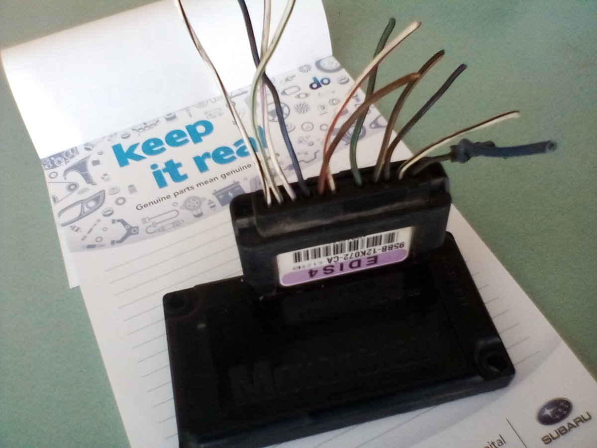

Got thinking as this fell into my hands from either a Focus or Mondeo taken out of circulation because nobody could supply an accelerator cable - so, it got the snip :)
There is no room to tack a trigger wheel before or after my EA82T crank pulley, and be a bitch to set up, secure a sensor....
What about mounting a sensor securely, out of harm's way on the bell housing, reading off Fuji's timing mark location - the flywheel !
You know, drill a 6 mm hole in bell housing, set engine to TDC#1 drill further, squarely into flywheel.
Set engine to timing reference of say keep it to Fuji's 20° BTDC on #1 , drill again into flywheel
Then you'd need some clever than me to CNC machine the 36 teeth or grooves into flywheel taking into account location if drilled holes...
sort of thing
enlarge hole first made in flywheel to fit crank angle sensor.
Yeah you could do the fly wheel setup. Range Rover did it this way with the P38. So it can be done  you might even be able to use one of these rings with the tabs on it for the sensor to reference, or use it as a template.
Another thought, can’t fit it inside the recessed crank pulley front face?
Cheers
Bennie
Used to be a lot of UK guys doing this to all sorts of once-were-dizzies style cars
36 teeth with one missing is simpler than Subaru three finger wheels and 36-2 style
One tooth for every 10°
Sounds like fun to tune
Shame can't just jump to that stage
The cam drive cog has 36 teeth
If one could have a tooth knocked out, shaved down and mounted to crank pulley machined to fit...taking up the unused V groove.. I get the feeling a sensor needs longer teeth to read correctly
Now see why those who have done aftermarket control have used the optical dizzy - I think it has 360 tiny slots in its breaker wheel. Better accuracy than 36-1 trigger wheel for certain
