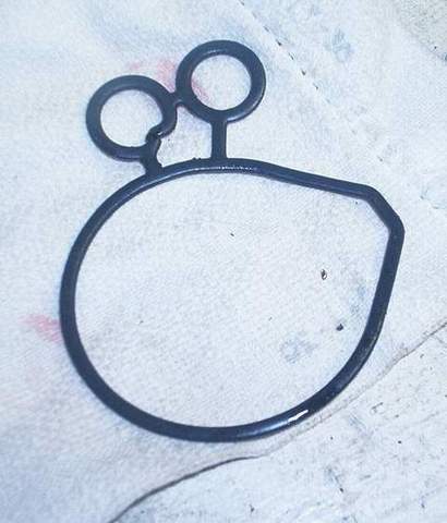

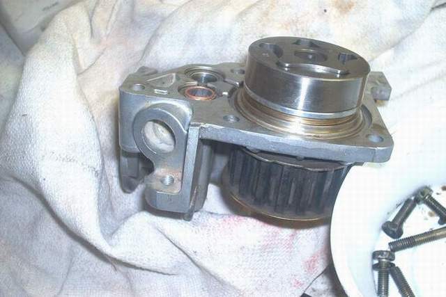

Just thought I would tell you about what should be a sure fix for keeping the the oil pump from sucking in that mickey mouse gasket we came up with. After replacing the micky mouse gasket on our EA82 engine in our stock car the ticking stopped for awhile but gradually came back. Just today my mechanic (husband) took oil pump off an EA82T engine that he is working on for next race season. The mickey mouse ear on it was chewed up & obviously had been sucked in. So he came up with what should be a cure to the problem. He inserted a piece of copper tubing in the suck hole leaving just enough lip to keep the gasket from sucking in. The tubing has got to be the right diameter to fit good & tight of course. It should at least eliminate one source of ticking issues. He loves coming up with these simple & cheap fixes for the common Subaru problems.

Illustration?
Hope pictures help along with a few more details. Pete used a 1/2" drill to enlarge suck hole. The length of copper tubing is approx. 5/16ths. He says very important to keep top of copper tubing flush with oil pump face. You can see in the picture of the gasket, which we removed from this pump, the suck side gasket is pretty messed up. The lip of the copper tubing should keep the oil pump from sucking in the poor mouses ear:grin:
