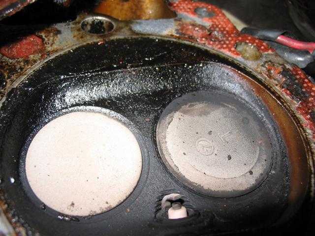

Ross Posted April 16, 2005 Share Posted April 16, 2005 Suprised to find no between valve cracks on the ea81t heads! Someone had put solid lifters in it though, i might see fi i can find some hla's. On a worse note, the coolant supply to the turbo was blocked! When i took the connection off the head, it looked like a blind hole. Dug out a lot of dry crap with a screw driver. This would explain why the previous owner replaced the turbo with a NEW one just before i bought it! Hope its still ok.... Quote Link to comment Share on other sites More sharing options...
erik litchy Posted April 16, 2005 Share Posted April 16, 2005 im not really a fan of the water cooled turbos anyway. they arent used anymore and are obsolete. new designs are more efficient and improved. must have been running horrible to be that oily looking though. Quote Link to comment Share on other sites More sharing options...
carfreak85 Posted April 17, 2005 Share Posted April 17, 2005 Hurray! A pristine set of heads! Wish mine looked that good... Quote Link to comment Share on other sites More sharing options...
Ross Posted April 17, 2005 Author Share Posted April 17, 2005 must have been running horrible to be that oily looking though. na, i spilt that on there:drunk: Quote Link to comment Share on other sites More sharing options...
