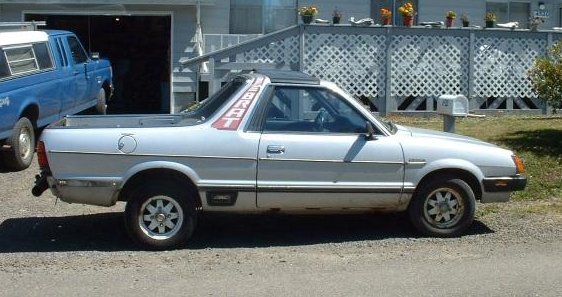

There are lots of piecemeal photos of individual parts I've been messing with, but I haven't done anything major to the body as of yet. Photos from when I got her:
