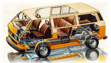

Have you considered the drivetrain from a westy synchro? You can even get the pre-made adaptor plate to put the EA or EJ subaru engine to the VW transmission. Gearing might be a bit low, since it's made for a bit heavier vehical. And you'd probably have to shorten the driveshaft to the front -- I think the wheelbase is longer than a bug. But it might be less work than a full subaru drivetrain. I hear the old syncro vans were actually pretty good in the snow, aside from being high center of gravity. Full time AWD with a locking center diff I believe.

that's a killer idea, almost all of my VW expierience is with air cooled, i didn't even think about a westy. now if only i can find one. looked around on ebay and autotrader, looks like it would be cheaper to go with that porsche drivetrain. saw one for $30k :eek: still hoping to find a way to squeeze the motor in up front, but a syncro is definatly a solid back up plan.
