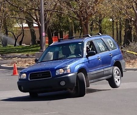

Diesel Posted April 26, 2006 Author Share Posted April 26, 2006 This is right before my tires get too hot to hold the course. Next time I'll slow down so I can get better times. d. Quote Link to comment Share on other sites More sharing options...
