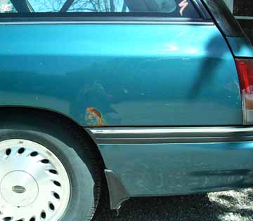

Now here's a thread I can relate to! Don't have any readily available pics of my Outback's many flaws, but here's my '93 Legacy wagon. In addition to the usual rust spot, you might also notice the dent just in front of the taillight (from a hit-and-run in an elementary school parking lot, no less) that I popped back out with my hand. Still a little white paint visible from the perpetrator's car, too.
