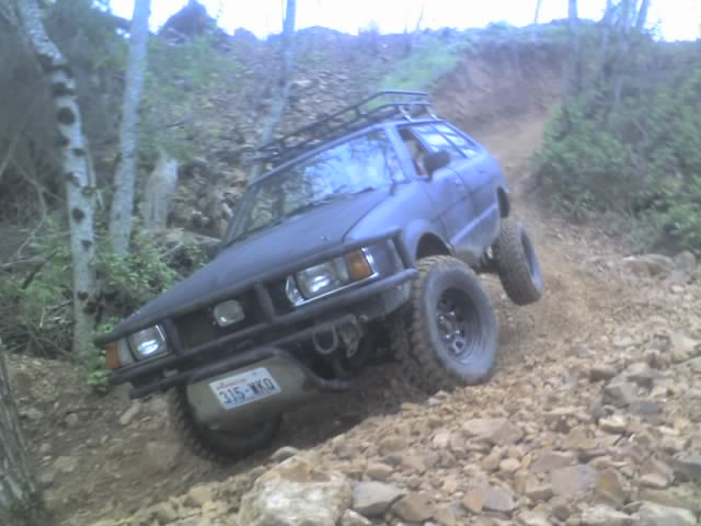

one eye Posted February 6, 2008 Share Posted February 6, 2008 Here is what mine looks like It seems to work a whole lot better than nothing. Jeff Quote Link to comment Share on other sites More sharing options...
one eye Posted February 6, 2008 Share Posted February 6, 2008 This is woody skid plate set up again, but on his brat it's the same one as on his wagon . Jeff Quote Link to comment Share on other sites More sharing options...
bheinen74 Posted February 12, 2008 Share Posted February 12, 2008 is anybody making a bumper such as this? i want sign me up This is woody skid plate set up again, but on his brat it's the same one as on his wagon . Jeff Quote Link to comment Share on other sites More sharing options...
