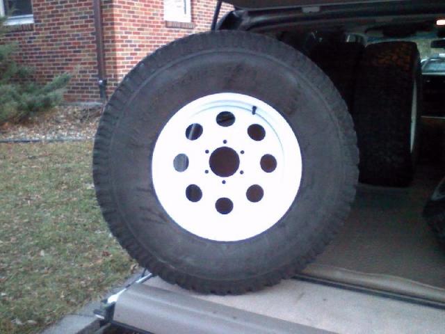

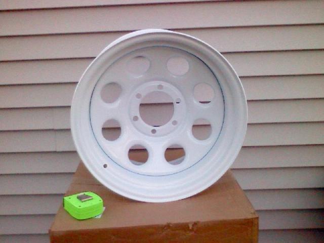

mcbrat Posted February 11, 2009 Author Share Posted February 11, 2009 woohoo. got my wheels today with correct backspacing... getting the tires mounted tomorrow..... Quote Link to comment Share on other sites More sharing options...

mcbrat Posted February 12, 2009 Author Share Posted February 12, 2009 Well, I (with support from my wife ) am attempting to keep the Brat looking like a Brat. It will have the jump seats in the rear (though not quite the same location, it'll be close...) I could not find any 17" wagon wheels, so I went with something close enough.... Quote Link to comment Share on other sites More sharing options...
Scott in Bellingham Posted February 12, 2009 Share Posted February 12, 2009 Well, I (with support from my wife ) am attempting to keep the Brat looking like a Brat. It will have the jump seats in the rear (though not quite the same location, it'll be close...) I could not find any 17" wagon wheels, so I went with something close enough.... I like those wheels:) Quote Link to comment Share on other sites More sharing options...
newsoobdude Posted February 13, 2009 Share Posted February 13, 2009 Well, I (with support from my wife ) am attempting to keep the Brat looking like a Brat. It will have the jump seats in the rear (though not quite the same location, it'll be close...) I could not find any 17" wagon wheels, so I went with something close enough.... Works for me too. ABSOLUTELY SIC man SIC:headbang:. Wish I had the funding and time to duplicate with my Wagon AND a Gen 1 BRAT. Quote Link to comment Share on other sites More sharing options...
