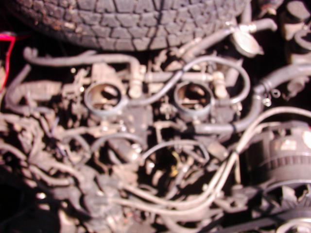

Uberoo Posted May 25, 2009 Author Share Posted May 25, 2009 problem is the 4 carbs would be the cheapest because the parts would be free.Just the set up and tuning would be difficult.Although I suppose because of the intake design a dual carb setup would work better.SPFI would be second cheapest,ej would be the best, but the most expensive. phizinza do you have any pics of the dual carb setup?what carbs etc? Quote Link to comment Share on other sites More sharing options...
Phizinza Posted May 26, 2009 Share Posted May 26, 2009 Mine are standard Jap import 101hp EA81 dual carb motor carbs, in other words Craptachi's. I've got some IDF 36's to go on, just need to make a new set of intake manifolds which I really should get around to soon as my car bearly drives atm when cold and not to great when warm. A single weber is better then dual hitachi's IMO. Quote Link to comment Share on other sites More sharing options...
DR DLEX Posted May 26, 2009 Share Posted May 26, 2009 duel DJG's set on EA71.re-jetted and modified Quote Link to comment Share on other sites More sharing options...
