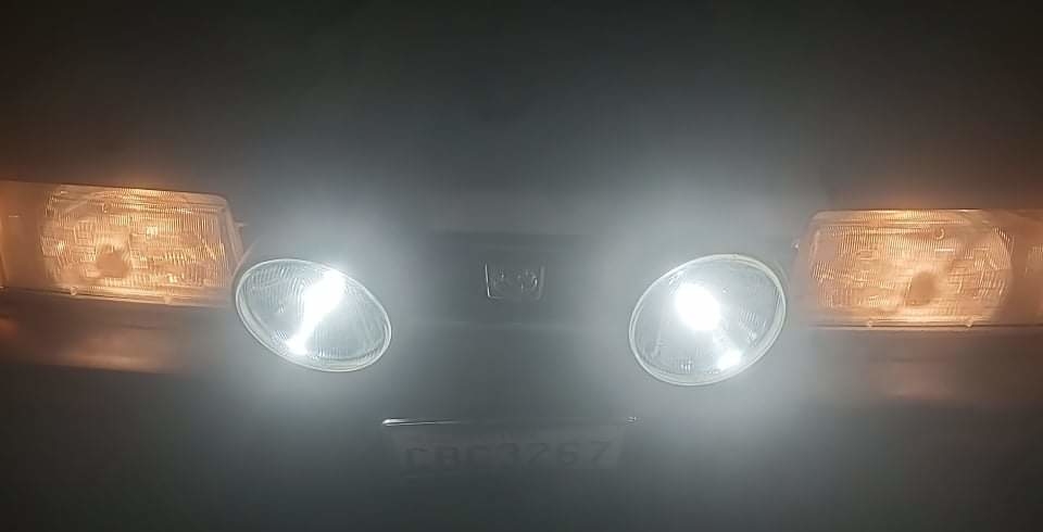

Replace your headlights already.
The lights that came out where probably from the early 2000's so maybe 20 year old, Sylvaina ExtraVision   The seal that attaches the front lens to the rear reflector had failed and the reflective coating was mostly gone, probably due to moisture getting inside it was a wonder they produced any forward light at all.  The lights pretty much fell apart when I took the bezel off.
Lesson is sealed all glass beams don't stay sealed forever.  And they made a really cool crashing noise when I threw them in the garbage.
And standard issue replacements are ridiculously cheap.
Has me wondering how the center light will weather the test of time since finding replacements for that is probably next to impossible.
