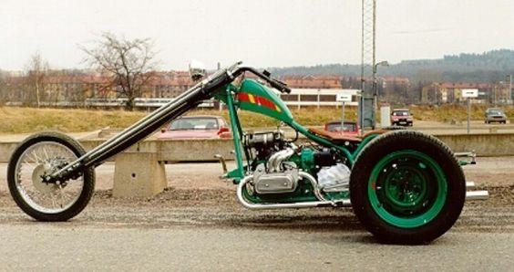

March 25, 201610 yr I want to build a mid engine trike and decided to use Subaru instead of VW. What are your recommendations for an engine, automatic trans combo that uses little or no electronics. What I'm shooting for, with changes to rear tire setup. Thanks in advance.
