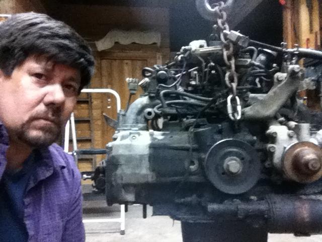

Tsuru Posted April 27, 2013 Author Share Posted April 27, 2013 (edited) Was delayed (getting some tracks down for the new CD) But last night I finally got the engine out! It was just like it was mentioned. I am considering swapping out the 17mm nuts for the 14mm, (again as suggested) for ease of access. Structurally I do not think it will make one whit of difference when used with an appropriate steel washer. It is not as if I am dealing with something that runs several hundred horsepower with torque figures to match. if the honorable Fuji Corporation were concerned about they would have over-engineered the thing in the first place. However, it is, I believe it to be quite adequately engineered. (like the old MB Willis Jeeps, simple and adequately powered) I am attempting to sort out how to post photos here. Oh, this seems to work... These was taken late last night...ok, early this morning (heck I could not sleep so I figured I'd do something useful) The oil filter looks like it has not been changed in YEARS! appalling really, the entire vehicle was just driven...and driven...with little maintenance. (By the way, I am the third owner of this beastie. She was bought locally and never left the valley) I like these kinds of vehicles, setting them right after all the neglect seems to make for a happier vehicle. Parents have a Cadillac that was babied and coddled all its life. (they are the second owners of that...thing...) She is a fussy bitch-made car from hell. "My Windshield has a spot, you left me out last night and i got dew all over me, and by the way did you know that it's been almost seven days since my last wash and wax!" If one can bring an abused vehicle back to working order, I think that it is better for it. Like a rescue pet, they remember the hard times and are willing to please you no matter what because they know they will be cared for...no matter what. The worst that can happen in your hands is still far better than anything that has happened before. Just my opinion. feel free to discount it and I won't be offended in the least. Thanks for the input on how to get this thing out, apparently I was over-thinking it. (as I am inclined to do at times). Once again, My gratitude is freely given. Respectfully, Timothy edited for grammatical errors and overall content. sort of... Edited April 28, 2013 by Tsuru Quote Link to comment Share on other sites More sharing options...
