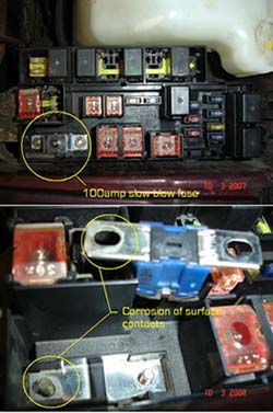

rysbrnr replied to rysbrnr's topic in 1990 to Present Legacy, Impreza, Outback, Forester, Baja, WRX&WrxSTI, SVXI checked each of the 50 AMP fuses and they were good. Next was the 100 AMP fuse. I started the car and took the back of a screwdriver and tapped around the nuts on the fuse and sure enough, the car shut off. I pulled the 100 AMP bolt-in style slow blow fuse and it had some corrosion on the curface contacts. I'm pretty sure that was the problem. used some sandpaper and a flat blade screwdriver to scrape the crusty corrosion off the contact points. To help prevent future corrosion I just slapped on a little electrolytic grease on the contact points. Problem solved. Hope this helps someone else who might have this problem. BTW, this was on a 2000 Legacy L Sedan with 197,000 miles on the odometer and still running great!

rysbrnr replied to rysbrnr's topic in 1990 to Present Legacy, Impreza, Outback, Forester, Baja, WRX&WrxSTI, SVXThanks for the responses so far guys. I'll check into the ground on the car. I know those could probably become corroded and cuase an intermittant connection. Nipper, I lose complete power to the whole car, not just the engine shutting off. Everything that needs electricity is off (dome lights, radio, wipers, heater blower, etc) Originally I thought it might an intermittant short inside the battery so to test this I jump started the car and disconnected the battery while it was still running...so far so good. it runs great without the battery connected and is not just running off the alternator. I take off for another drive and BAM, happens again even without the battery connected. So now I know it's not the battery. That's when I jumped on USMB's to see what you guys thought.

Anyone ever deal with this before? My 2000 Legacy L just started doing this. It does start up and drive anywhere no problem. But randomly the car would just shut itself off and die. But in this case, the whole entire car shuts off, (headlights, radio, pwr windows, etc) as if I just removed the keys while driving. The battery is fairly new and I just had the alternator checked today. They are both deemed to be in good condition. When it dies, NOTHING comes on (dome lights, radio, heater blower) nothing! I would disconnect the battery and in a few minutes, re-connect the battery and the car would start up and drive like normal. Is there some main relay that could be going bad? I'm not too confident about driving this car around now until I KNOW exactly what's causing this.
