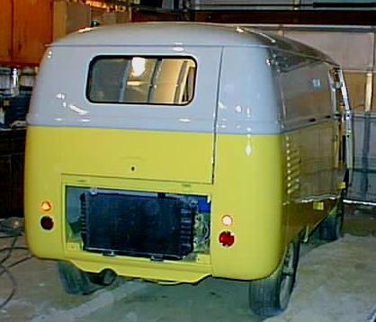

  1. My 60 VW panel van has an EA81 engine and it fit EASILY in the engine compartment,and I used the KEP adapter. The radiator, a stock 80's suby was put in front of the engine cover,on hinges so it can tilt out, and a modified engine cover was installed.It has 2 cooling fans(electric) that pull air in from the back.It cools fine,but restricts engine access somewhat. Look at my other posts for pix and more info.

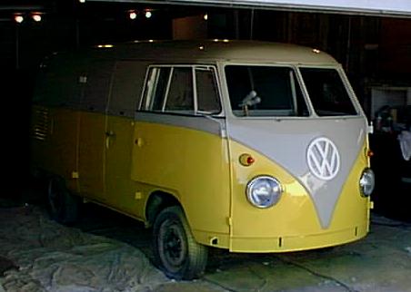

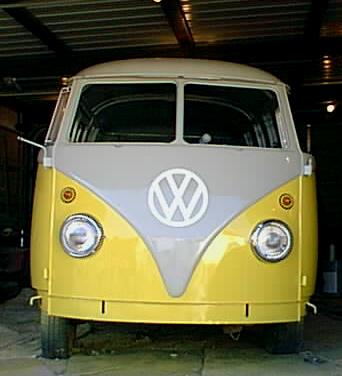

  11. Havent had a chance to road test much yet,but the power band is excellent.Got wheels powder coated and new tires on and they look niiice.All windows are now in,though there aren't many as it is a panel van.

  13. Well the bus finally got some paint on her and we've been trying to finish up the outside.. Right now it's still lacking a windshield, engine cover, tires&wheels, exhaust and a few odds and ends.. Pictures are in the gallery and hopefully in this post. Thanks for all the positive comments and feedback, keep em comin!

  15. The radiator is a stock 82 suby that cost $129/w a lifetime warranty.Top hose is extra long to facilitate opening.Fans are both stock 80's suby and have plenty of clearance. Tranny supports engine fine,but a xmember could be fabbed easily enough if needed. Now if it would just warm up so I could finish painting my subybus!
  16. Hey that is a new radiator man.Orilleys doesnt paint them that well. The original engine cover will not be used,but I have some ideas about fabbing one with angle iron and some special expanded metal.Always open for ideas though.
