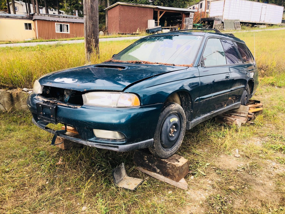

Hey everyone thanks for stoping by to verify that the Subaru service tech is accurate- he says that there is a 99.9% chance that the 1998 Legacy wagon and Outback has the same 5 speed manual transmission..... Please leave your vote if this is true or false? In the morning I will go and harvest the transmission my friend just found for me. The story is that the owner left the window open and a bear crawled in and destroyed the interior. The vehicle was in perfect working order at the time so i am scoring the vehicle for the cost of hauling it away so I can improve the longevity of my 20 year old beast! The engine has already been removed so any tips on a quick removal of the tranny will be appreciated as I don’t own a Haynes.... all the best, johnny

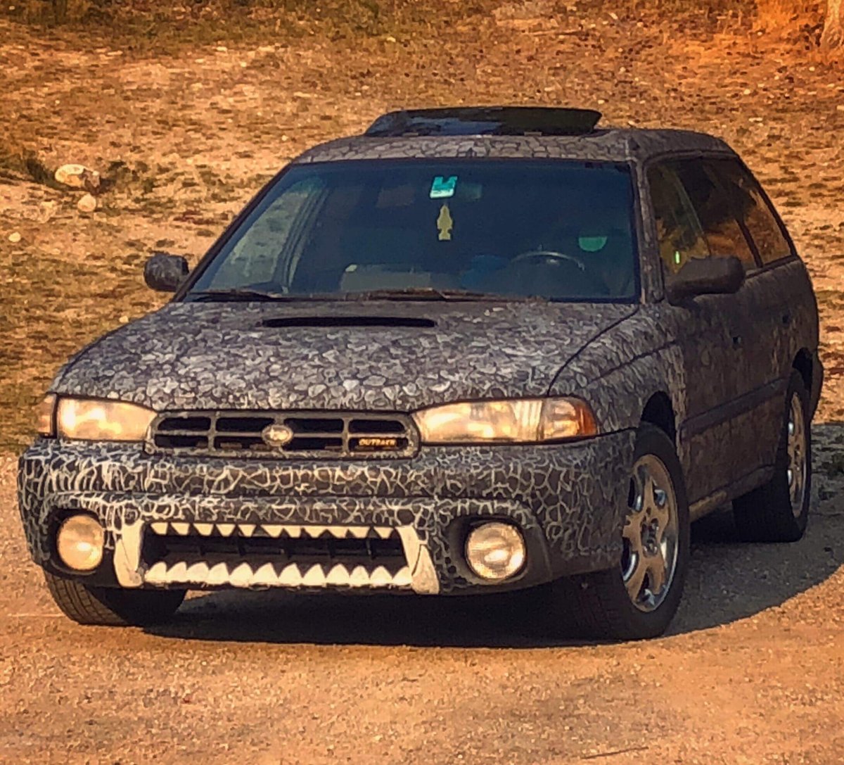

Hello All !!! Before I say anything I want to say many thanks for all your help and input. After my weekend protocols I was able to remove the side panels. The belt looks good however after letting my Mechanic that I bought the car from in 2007 hear the noise throughout the phone he confirmed that the water pump pulley has gone bad and the car should not be driven. Fortunately I was able to make my shoot on Thursday and she did handle the 48 km round trip to the location. Thanks again for the help to prevent the loss of such a young rebuilt ej22 of under 96,000 kms. All the best and have a great spring everyone. Here is my Thursday production - made possible with my diligent 1998 Olympic Outback! Johnny
