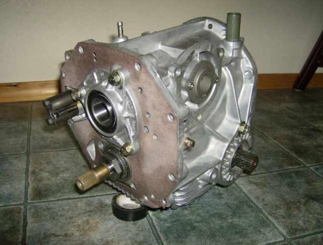

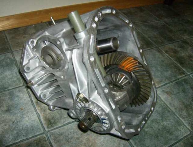

  5. well the diff gears in the front are in pretty bad shape as the owner before let the oil leak out of the spline shaft seals go too long i.e. no oil. Changing the oil in the diff didn't help a whole lot in the growling noise and loose gear meshing from the wear I can only imagine happened. So I picked up a factory new front diff (at a steal or I wouldn't of ever dreamed trying to change it out.) From the looks of it it is just 9 or so bolts from the tranny into the diff and then about equal amounts of bolts from the inside of the bell housing that run back into the diff. I've searched and haven't found much on people actually cracking the 3at open on the front end to replace the diff. My modulator is in good but I'm going to get a new one with the swap just so everything is back to the way engineers designed it. I haven't had erratic shifting at all. Like I said the tranny drivability is still great, it is just the whining diff that I'm looking to nix. I'm curious, the shaft that will mate up with the torque converter, there are no splines, how does that hook up? Here some pics of what I'm looking at, notice the factory new paint marking on the gears.
  6. Not to hijack but I'm about to pull my 3 speed auto to replace the front diff housing portion on my 4x4 tranny. Wife will just not let me put a 5 speed in. Is there anything I should know perhaps tools, procedures, or gaskets between this unit I'm putting in and the flywheel housing and the tranny itself? I have never taken an auto transmission off the engine, torque converters have always been this elusive thing I knew was right behind the engine but never see it. I think my torque converter still has plenty of life left but should I watch out for anything in there while taking the tranny off? Also, this may sound stupid but can I change fluids in the tc? I don't think the fluid in there circulates with the regular tranny fluid loop. I've got the manual for how to keep your subie alive but it is pretty brief on auto tranny repair specifics. Thanks for any help
