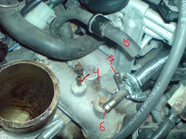

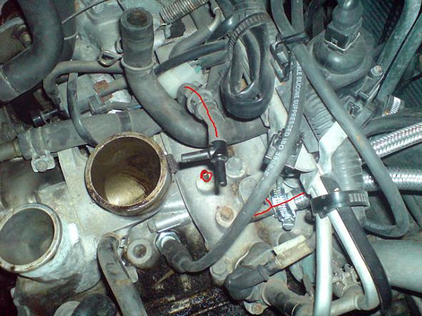

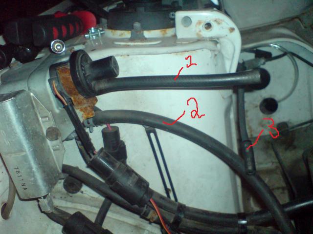

  2. i can't see to get it right. I have taken some new pics on how i connected it now. Can someone pls explain what goes where if i have connected wrong. I will give all outputs and hoses a number so it's easier for me to know what goes where. I suck at english so i think it's there my problem is I numbred them from 1 - 7 and pls use the numbers when you explain. I know what the intake boot is and the canister in the front i call just as easy as black canister The pics: http://i45.tinypic.com/3038w0k.jpg http://i48.tinypic.com/2e4ezjt.jpg Some help really soon would be a killer thanks all for the help i got this far !
  3. Hi. I dont have a repair manual and the schematics on the hood is barely readable But i dont think i will know exactly where all should go. Cant see all the lines on the drawing. But pictures from an engine would really help me
  4. Ill need alot of help with the vacuum hoses in my EA82T Subaru RX 1988. I have uploaded some pics with the lines i dont know where they should go. Can someone please take a picture of these lines or a good drawing where they should go and so on The car is being sold this weekend thats why i want it fixed. Cant find any good picture on the net. The black plastic T-cross on the second picture i dont think should be there but all help with the lines would be great !
