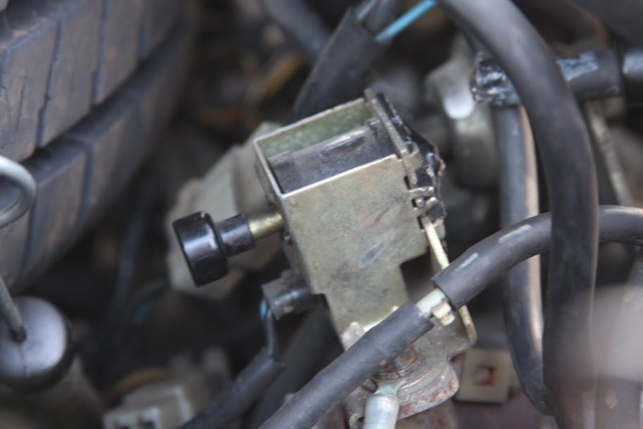

http://lh6.ggpht.com/_czIamuN1qLs/Sp3WKOc8KrI/AAAAAAAAAOk/1zaES8PK2y4/s912/IMG_3890%5B1%5D.jpg
with and without the linky thing
my haynes repair manual calls it "solenoid valve 1" ... not very helpful.
on the back it says hitachi and AESUI28 or AESU128
i think it might be an EGR solenoid valve but im not sure - no parts people including the subaru dealership knew what it was ... so i figure ill put the internet to good use
basically the story is that someone prior to me had silicone ed the vacuum hose onto it(the mystery part) because the nipple the hose should attach to is broken off. the silicone has has decided to fall off causing a vacuum leak which causes the engine to idle poorly and has caused me to go hunting for a replacement instead of just ciliconeing it back on ...which i might just do
i do like me some long run on sentences
