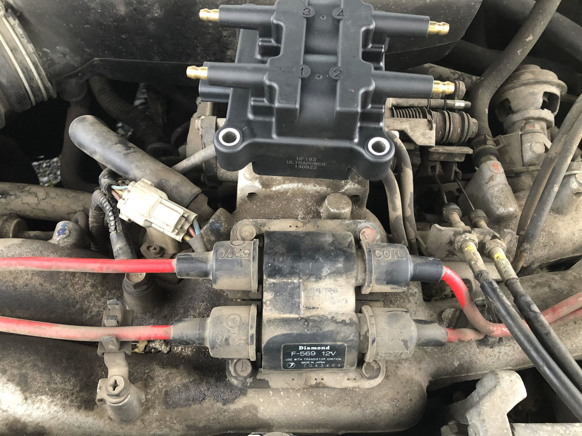

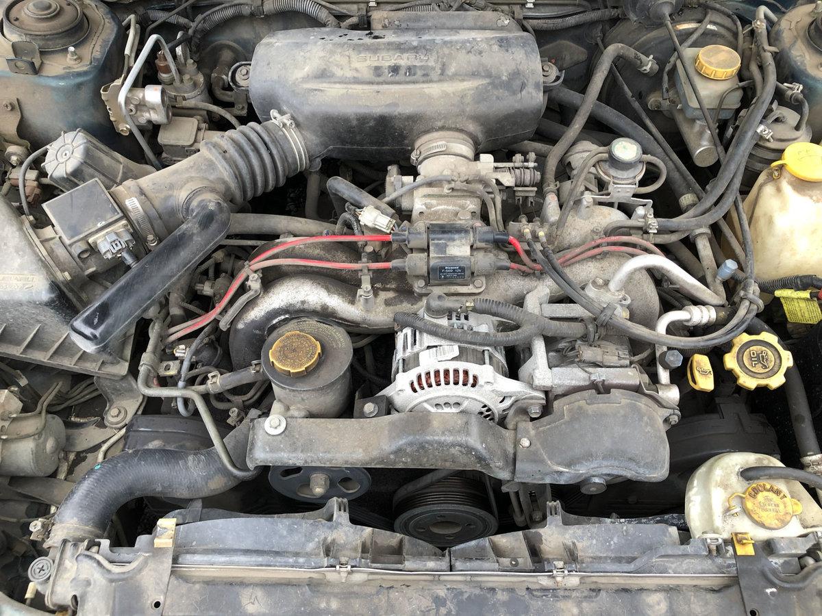

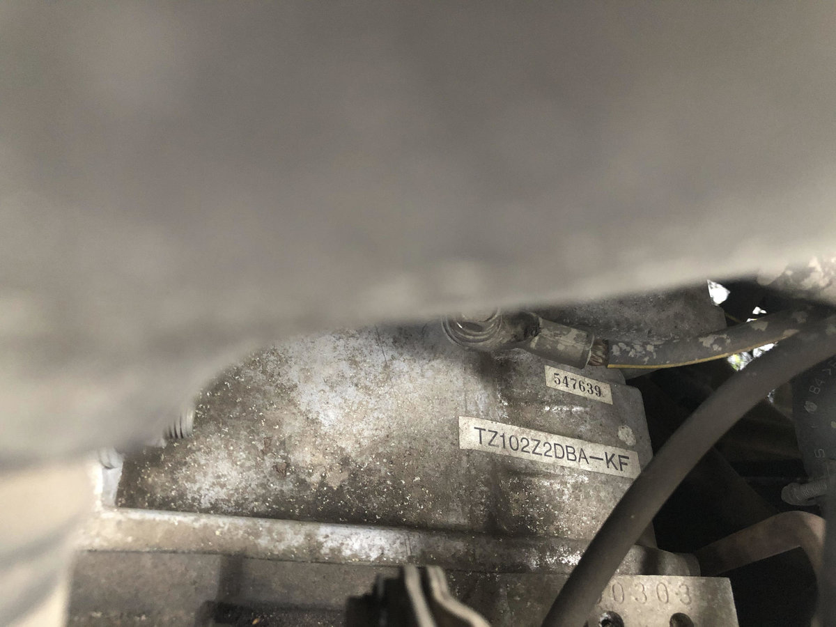

GorgeSuby replied to GorgeSuby's topic in 1990 to Present Legacy, Impreza, Outback, Forester, Baja, WRX&WrxSTI, SVXGotcha GD, Will not replace that coil. I think looking at the wires it is an early 96 EJ25 but here are some pics of the engine & passenger side heads...Also the tranny numbers match so probably not an EJ22?
98 Legacy Outback Coil mismatch
GorgeSuby replied to GorgeSuby's topic in 1990 to Present Legacy, Impreza, Outback, Forester, Baja, WRX&WrxSTI, SVXThanks! Will take some more pics... quick look on Napa website shows my coil for a 95 Legacy EJ22 so looks like you're right...
Hi guys, I am trying to do a tune-up on my 98 Legacy outback & ordered a wireset & coil from Rock Auto months ago. Finally went to put it in & it was all wrong. I thought it must be a mistake so went down to Napa to get the correct set & the one the pulled up is the same as Rock Auto. Now this is obviously wrong - the coil on my 98 has the female sockets for the plug wires & even the bolt pattern is different than the one I got on Rock Auto so it wasn't just a coil swap. My ID plate says 98' EJ25D which seems correct... Any ideas? ... What gives?
